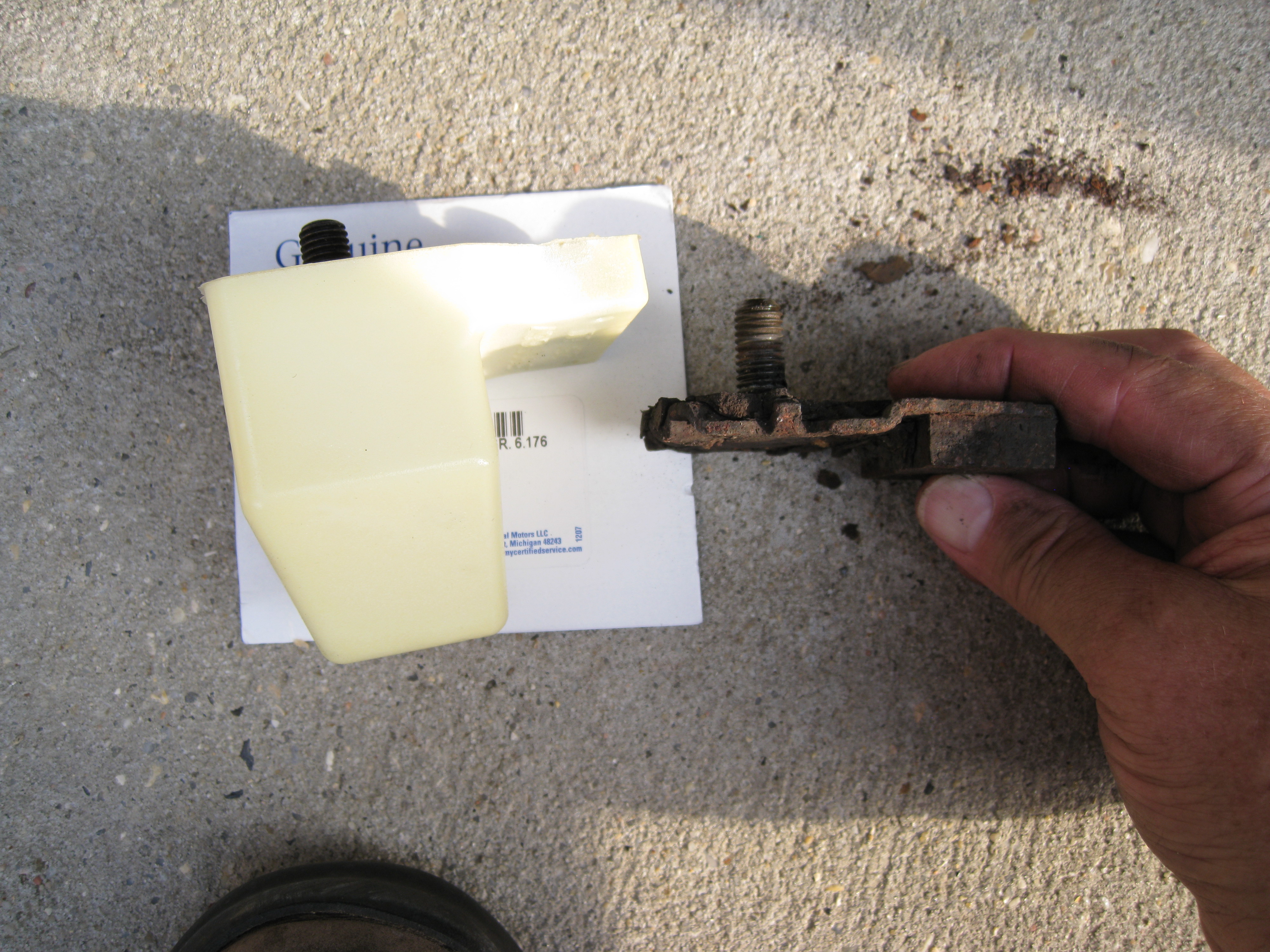

Well, I can't get the nut off the left front shock, can't keep the inner spindle from turning. So looks like I'm getting out the dremel and cutting off the nut and/or spindle. At least I got the bump stop changed out.
