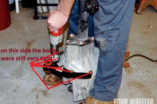

I noticed some of the bolts on the diff were loose. some of the bolts were so loose I could turn them with my fingers. I tightened the bolts to 37ftlb of torque and not a drop of oil yet .I still need to take it for a longer drive and check again.
Attached Thumbnails Leaking front diff. Rancho lift-101354.jpg   Leaking front diff. Rancho lift-129_0905_06_z-hummer_h2_suspension-differential_support_bracket.jpg
