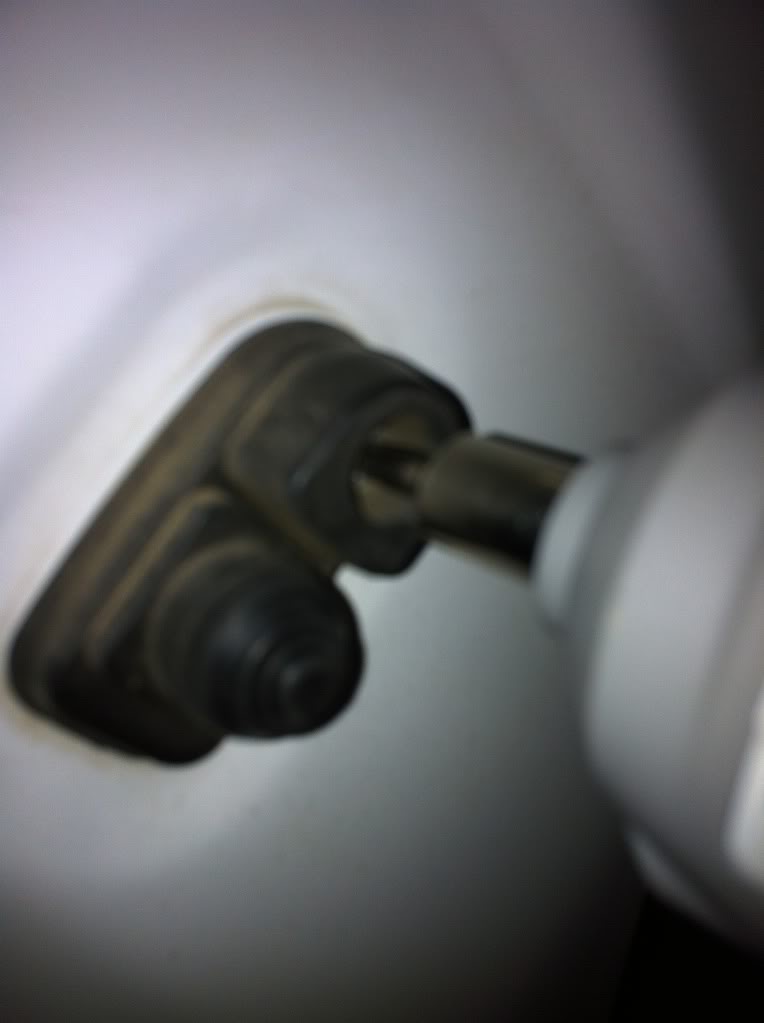

Hi and welcome to solve the problem behind cd /radio won't turn off automaticaly when opening the door and the key is out of ignition
this is due to bad oxidation in switch contact in the door panal so let's solve the problem

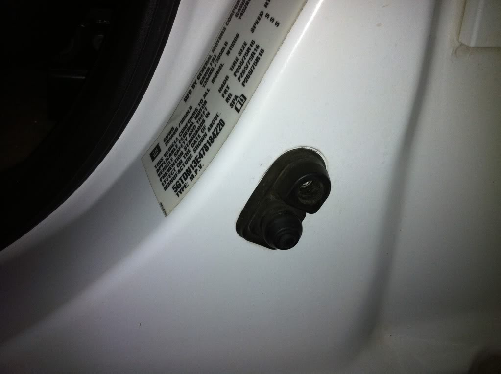

first remove the door switch
Attachment 13919
i think the bolt is star type
Attachment 13920

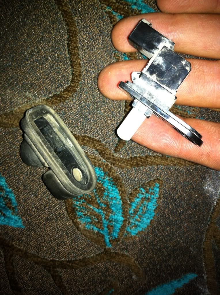

now you have the switch first remove the rubber cover
Attachment 13922
use - screw driver just remove the cover don't be hard these plastic cover are very easy to brake
Attachment 13923

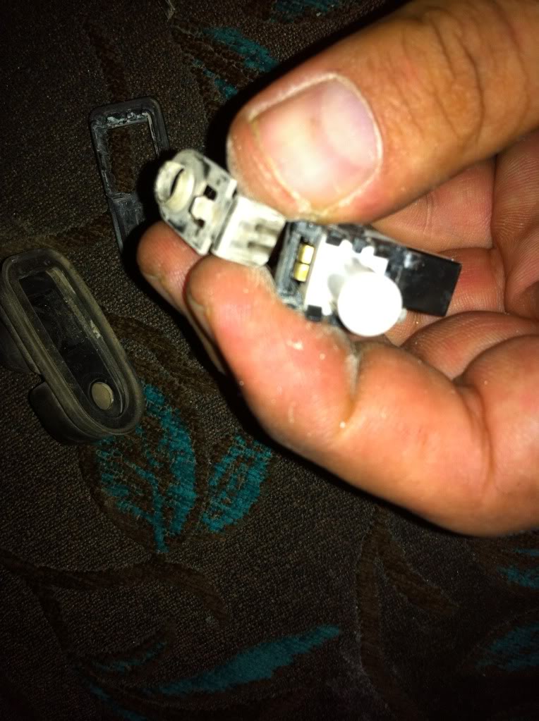

the cover removed remove the metal bar next
Attachment 13924

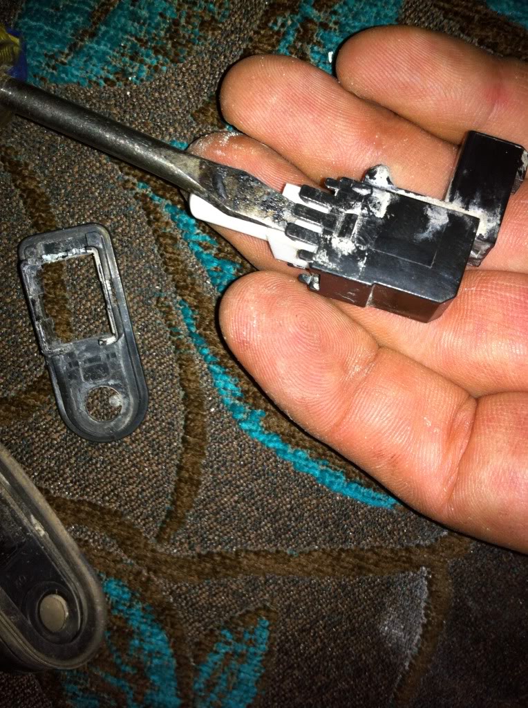

now remove the button as you did in the cover
Attachment 13925

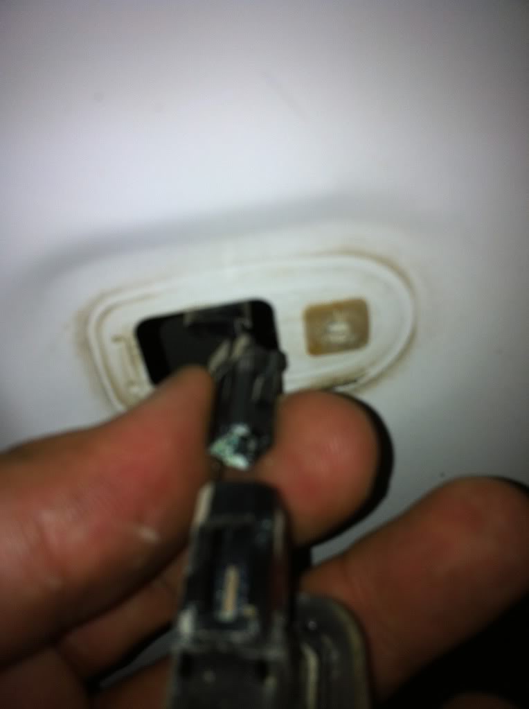

chick out for oxidation and use oxidation remover spray but dont forget the inside two metal
Attachment 13926
too much oxidation here:eek::eek::eek::eek::eek:

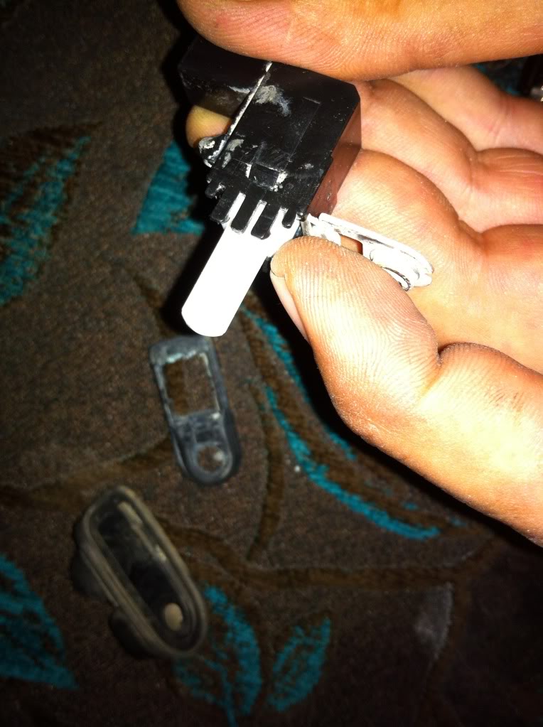

Attachment 13927
Attachment 13928
install back the button first then the metal
Attachment 13929
Attachment 13930
last thing re install the rubber cover and screw the bolt chick out if the key in ignition u must hear ding sound once the key removed CD player will turn off and the dome will light any time you open a door
