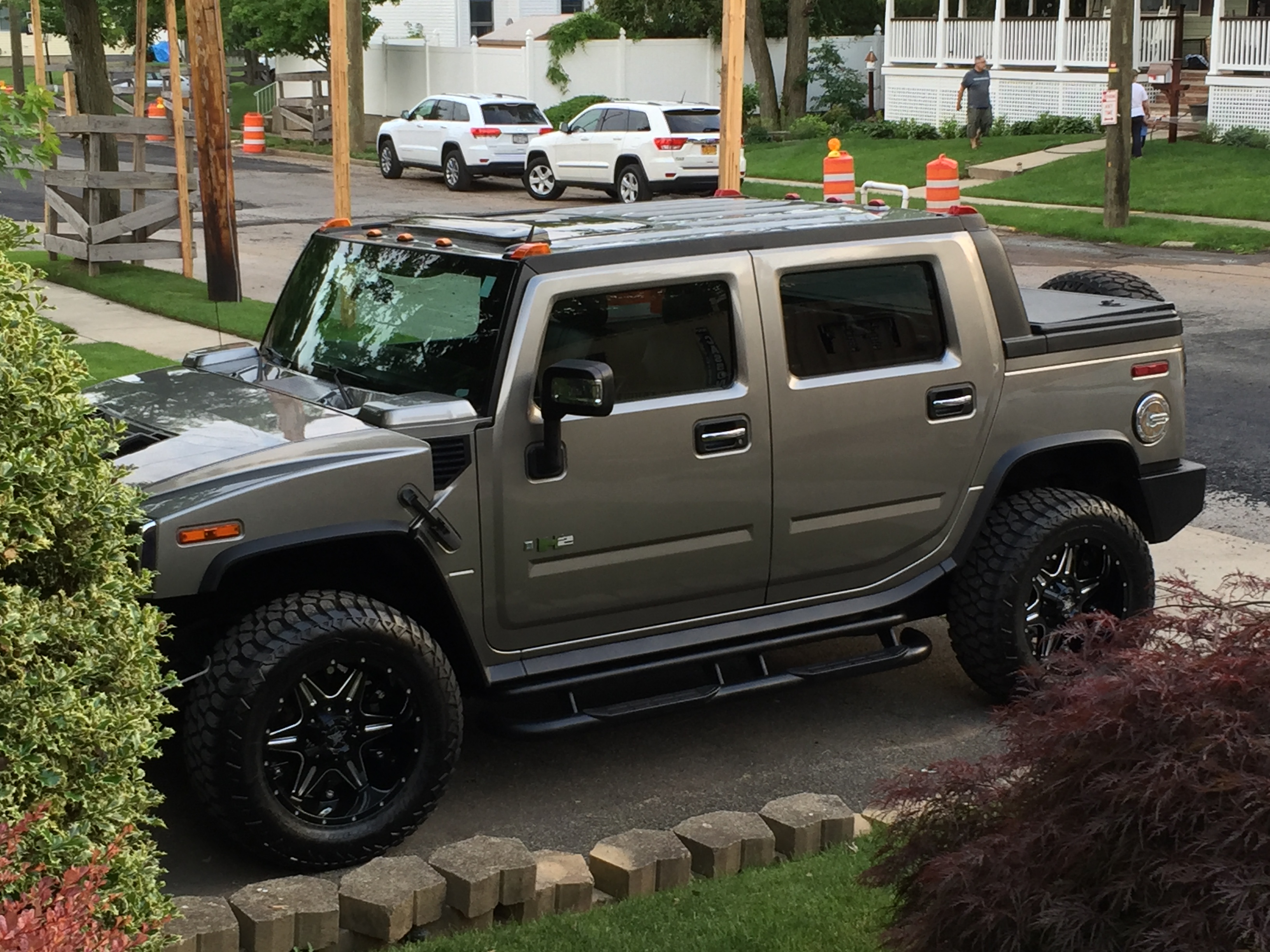

Default A couple of pics
So the issues I have found out so far: needs an alternator, cruise doesn't work but light is on on the cruise button on steering wheel, and side view mirrors fold fine but the driver side mirror itself does not move at all electronically and the passenger side mirror only moves sideways.

Old Jun 5, 2016 | 12:41 PM
Synthetickiller's Avatar
Joined: Sep 2014
Posts: 813
Originally Posted by mcioci
It's a big diff bet the 08-09 vs the other years. The trans make the difference. I love it. I don't think it's the window switch because when I try to move the mirrors you can hear the motor trying to move the mirror. Bi think both mirrors needs to be replaced. If you think changing the switch is worth a shot I will give a try. Now I'm getting check tire monitoring system icon flashing on DIC. All tires have about 65 psi. I will have to research this one. Thanks for your input it's very much appreciated. I will post pics tonight.
Well, it sounds like the signal is getting to the mirrors. I'd start there.
Does the DIC show the PSI for each tire? It's in the 2nd menu (2nd button from the top to the right of the steering wheel). If it's not showing PSI, you most likely need a new set of sensors. You could try to reprogram them first. I can dig up a link if you can't find how.
What size wheels & tires are those?
It looks nice man! Congrats!
