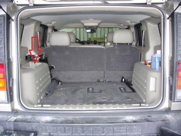

I did not want the jack taking up space either. I popped up the pocket on the drivers side cargo panel. Mounted it in their via a long bolt. Dont just drop in there as cargo sliding around after the jack slides down will crack the panel. Dont ask how I know.
Where exactly are you talking about? Is this in the SUT or the SUV? Please add pictures. It would be cool if I could move the jack, I've had people get upset because they got grease on them while climbing in the back.

I am away from my H2, the picture illustrates the pocket you lift up and you will see some room to tuck the jack. Thinking about it I could have just wrapped it with towel and probably been fine.

I went out and played a bit that pocket. How did you get past the little clips? It looks like 6-10 little clips. I has a pain to get even 4 of them lose, the two on the sides didn't wanna move at all.
