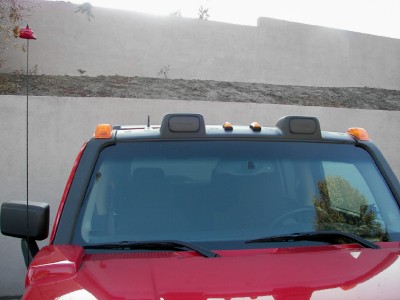

The install is really pretty easy, I actually found the directions hard to follow so just kind of used common sense at least until I came to the wiring, then I had to use the directions. I just looked everywhere and cant find them now, probably threw them away after I was finished.
