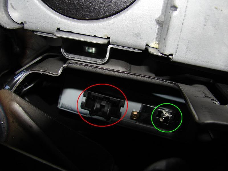

Once that is off find your XM module and remove the plug (in red) and the antenna (if you want to reuse the XM antenna (in green))

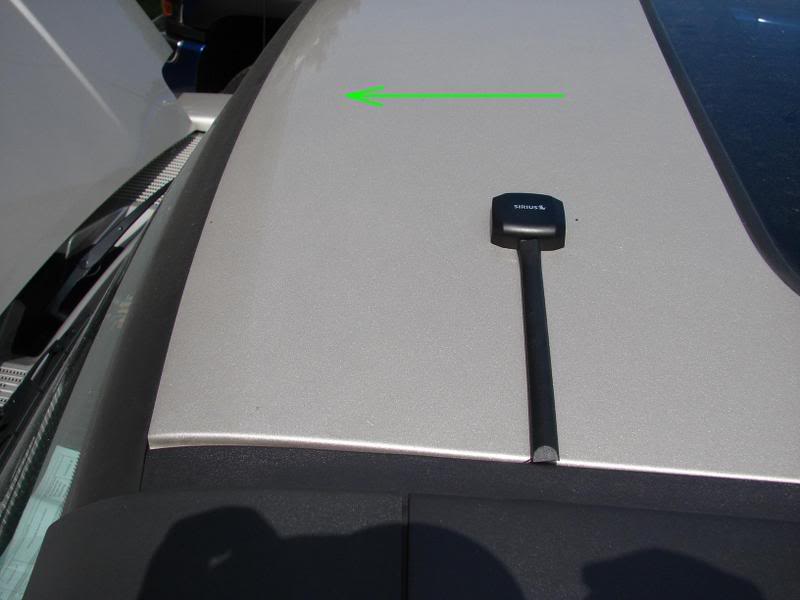

Now since I blew apart the factory XM antenna wire with my ham hands I had to run the Sirius antenna so this is how I did it. This is where I mounted it on her roof the green arrow shows the front of the vehicle. I ran the cable under the plastic (more to come on that):

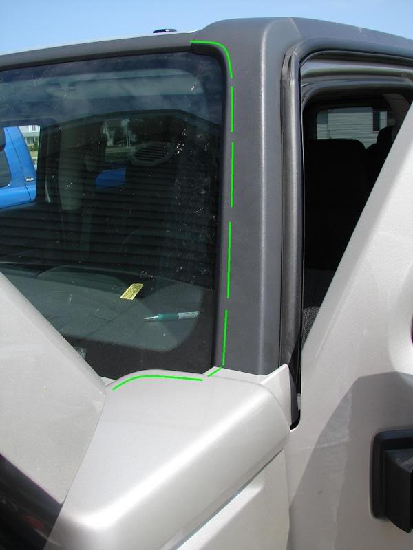

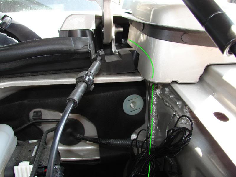

Here the green dotted line shows where I ran the antenna cable under all the plastic that lines the windshield and down into the hood area:

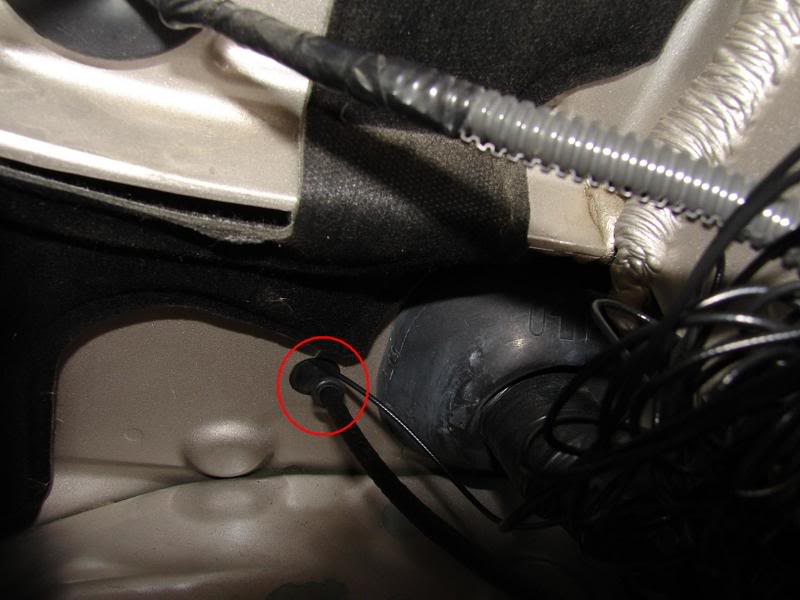

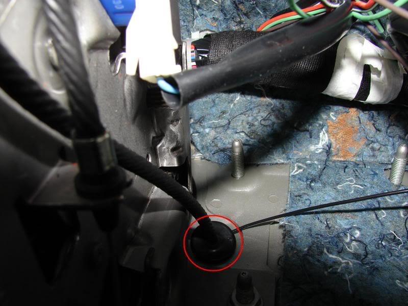

Now inside the truck find the hood release cable and follow it back into the firewall. There is a gommet there that you can wiggle, pull, and remove from the firewall to run the antenna through. Here it is circled in red, in this picture you can see I all ready replaced my grommet and my cable is already run.

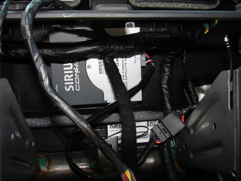

Once the cable is inside the truck I ran it over the steering column and into the radio area (not pictured). I then mounted the SIR-GM1 module, it fits real well on the duct work for the heater/AC. I used thick double sided tape and a few screws. You can also see the cable hookups in this picture.

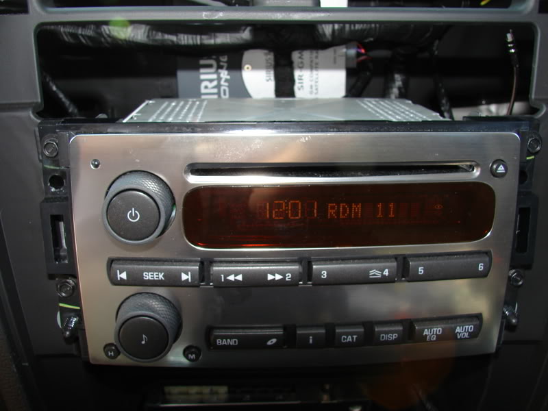

reinstall the radio (you can see the SIR-GM1 module peeking out behind the radio)

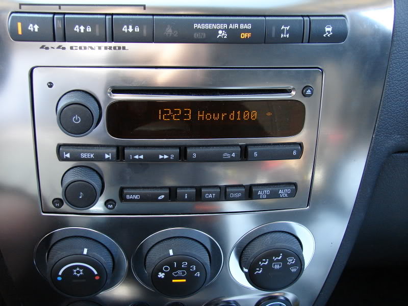

Put the face plate back on and enjoy your jams:

Very good write up wz56, very detailed. One thing you should be aware of though .. the prefered antenna placement is on the back part of the roof. It requires a little bit more work, like taking some additional interior panels off, roof liner, a-pillar trim and so forth. I doubt you will see much of a difference with your location though. For what it's worth I ran mine in from the back on my H2. Through the 3rd brake light access hole, above the roof liner and down the passanger side a-pillar, under the dash, and up to my tuner. Then of course I didn't remember to take in the slack so when I was all done and I went to close the flippin' rear hatch the cable was in the way and I promptlycut the !@#%$!@#$!@#$!@#$ thing straight through ... now I have my antenna sitting on the very front of my dash, mushed up against the windshield ... I about broke my sorry sad self in half installing the first one ... I'm NOT doing it again any time soon .. besides .. it works pretty damn good even sitting on the dash.
