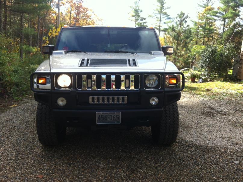

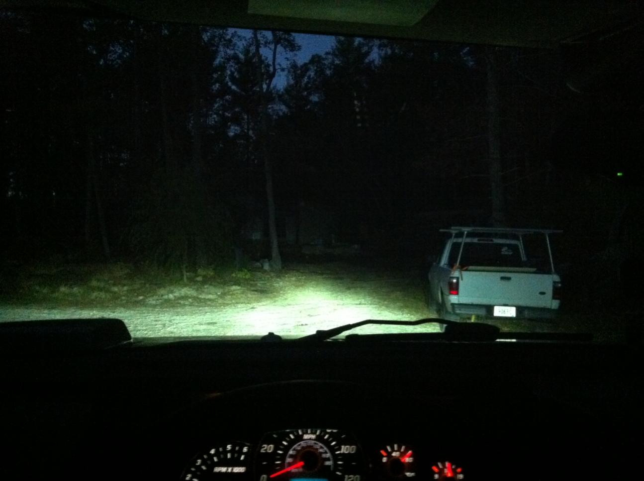

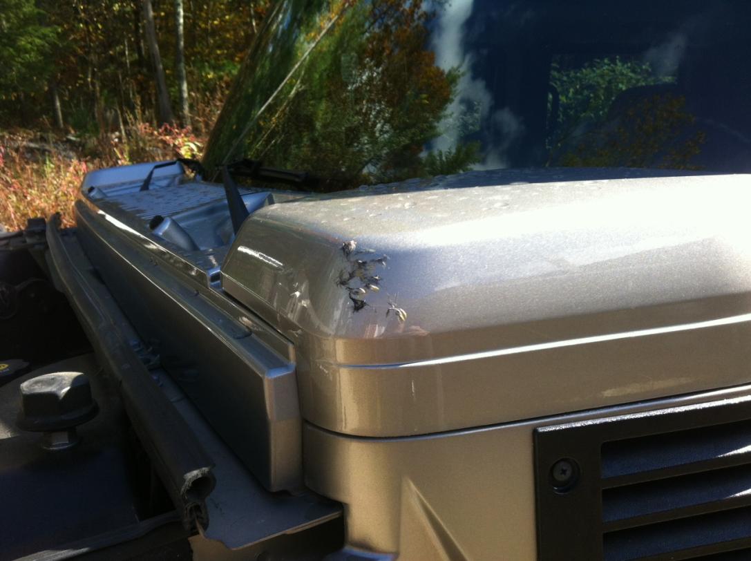

So after looking at my new HID's in their box for the last month I finally was able to install them. Everything went alright. Only issue was the cables were just barley long enough. The look wicked nice, I went with DDM Tuning 35watt 5000k Bulbs and they look really white. I love the overall look. I also realized halfway through the installation I had hit a bird sometime the day before. Feathers and some organs marked the impact. Gotta love my Hummer!!! Wish I had better before pics but you get the idea. For reference the shed in the high beam pic is 150ft away.

Exactly,
Like you said (for example) 5000k with 35watts is pure white, but 5000k with 55watts is white with a hint of blue. Also DO NOT order the wiring harness because you don't use it (If your getting the HID's on High's/Low's). Didn't need it at all.
Sadly the mounting brackets were useful (for me)
Ill put up the pic of my set-up LoJac, only because i'm not sure how hot it will get and it might be too close.
I paid $77.92. The Cables are a bit short so that sux
