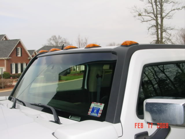

Took me about half a day, was not real difficult. There is just no room to work with above the headliner, forget about it on the driver's side,the steering wheel gives you zero room. Ran into a problem with the 2 outside lights, could not find the wires when I dropped them through, ended up drilling 2 more holes for easy access to them, I figured what the heck already drilled 15 holes what's 2 more. Thanks to all that made posts on how you did it, gave me the inspiration to do it myself and save $1100.[8D]

Damn that looks so frikkin good! So much cleaner than the factory markers with the big plastic plate and I'm sure it's quieter too.
I've got my Chevy cab lights by Pacer ordered. It'll probably be home when I get back there the end of the week. I'm in Tenn. this week working.
Robday, you mentioned problems with the outside lamps. How are they mounted, are they just screwed into the black plastic runner and then the wire goes down through the metal roof right under that? Are the lamp assembly retaining screws self tapping?
Also, you mentioned running those wires down the pillars and having to drill holes to fish out the wires. Did you have to run the right corner lamp wire down the right pillar and the left corner lamp wire down the left pillar?
In my mind I was thinking I'd tie all 5 hot wires to one single wire and tee off that wire to each lamp and run the main wire down the driver's side column down to the gray wire inside the side of the dash as shown on one of the other threads and run ground wires to the lamp retaining screws that touch the metal roof.
If you did it different could you elaborate on how you did it.
I have no desire to re-invent the wheel here. I think I may have to take a valium just to get the stones to drill 15 holes in the roof. *LOL* I've read the other threads and no one has really mentioned specifically how they tied all the wires in and how the outer lamps actually mount.
