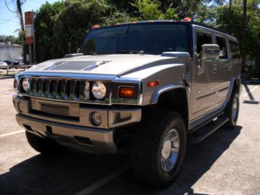

I am parking The Beast in my garage next to my Nissan Armada and I have the Factory Rim's and Tires on this hummer but I am wanting to get some different Rims and Tires any Ideas? I also want to add that as of right now its Sitting Factory ( no left ) and at the highest part of The Beast I am clearing the top marker lights by prob. 2 or 3 inch and I don't have the roof Racks on top either.So I know that's a mouth full but I would like to get bigger rims but I'm worried about keeping the Beast at its currant height and also get some roof racks for it.

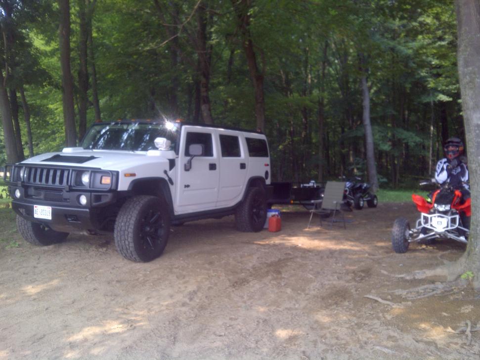

Here's a pic of mine:

Originally Posted by LoJac963
If you want to keep the offroad capabilities and look of the 2 then stay with the stock 17" size or 18". You want big sidewalls, not to mentioned tires are half the price of 20's.
Look at Method race wheels. That's what I put on mine and others have used. They are great wheels and the black coatings look awesome!
Sweet rig LoJac. Tastefully done.
I totally agree. If you're into any hardcore wheeling such as rock crawling etc. you are going to want to stay with 17's or 18's. To be able to air down and have your tread envelope the terrain. I was going to go with 18's and M/T's but my jeep friends tell me my deuce would never make it through the trails we have as the jeeps barely fit. Not without caving in doors and quarter panels.
Will my 20's and a/T's get me down a fire road to where I need to drop my atv off? Yes.
Could they get me to the swampy bog my jeep is stuck in ? Probably.
It all comes down to what your needs are.
And yes 20's are expensive especially in Canada. Mine were $500 and change and he knocked 50 off each.
I think if you went with 20" rims and 37" tires you would have the sidewall to be able to air down for wheeling and it would update the look of the deuce. It would be pricey though. JMO
