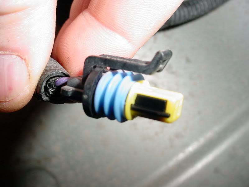

While it's draining..Disconnect the electrical connector from the Speed sensor (Upper left and to the rear a bit on TC) ...Gently pry up the little tab just enough to unhook it from the speed sensor while pulling out..Don't break it off

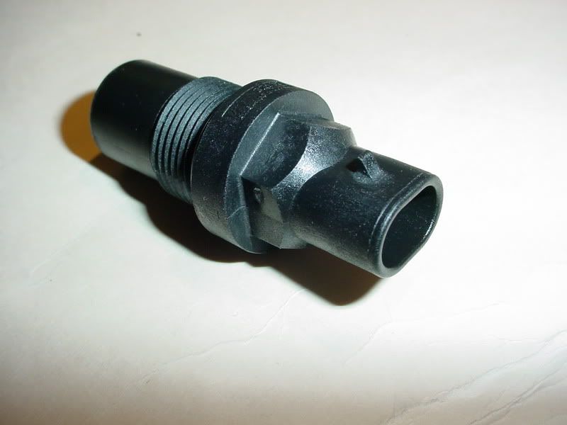

Clean the area around the sensor, then with an adjustable wrench, Unscrew the Speed Sensor..Be careful..it is not on very tight so a lot of force is not needed.
Once you have it out..wipe off the end that was inside the TC..it contains a magnet and may have metal fillings stuck to it.

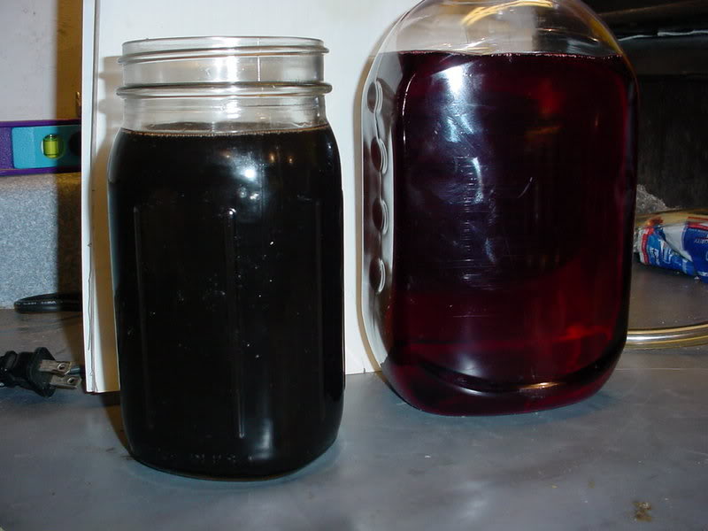

By comparison..the Old fluid with only 25K miles on it of normal city driving, vs the New Fluid
