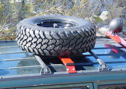

Hello,
I would like to remove my spare tire from the rear space of my 03 H2, and I do not want to put it on the rear hatch. I would like to use the stock roof rack and put the spare tire up there without getting one of those GOBI rook racks. Just a simple spare tire carrier that attaches to the existing H2 roof rack. I have seen it for a Jeep (as in pic), but not for the H2. Does anyone know where I can find one?

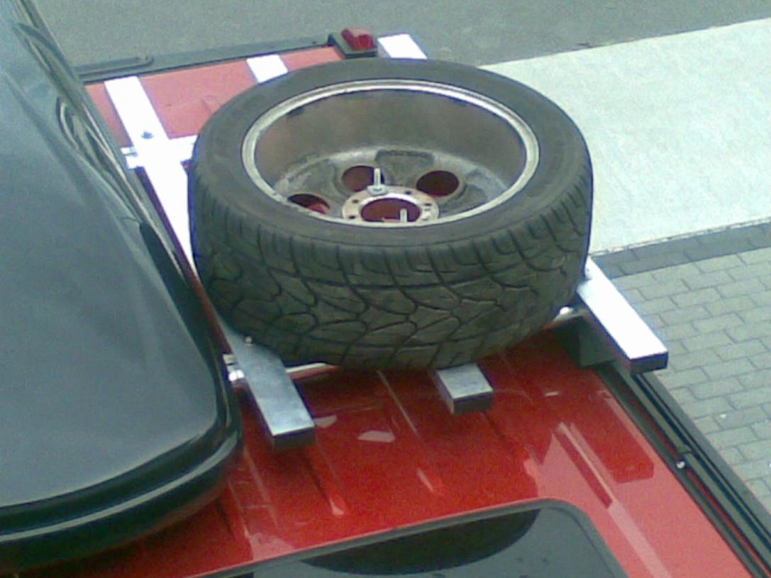

Hi, here is how i did this for my summer trip, 3 70x40mm aluminium profiles and 2 long bolts through the middle profile to keep the wheel down, this hasn't budged since i set it up, pretty solid. A bit high though...

Thanks for the info. I was thinking of building something simmular, but was wondering if there was something out there alreadly made.

well the best one I have seen is from a company called GOBI, kind of costly. About 1400
