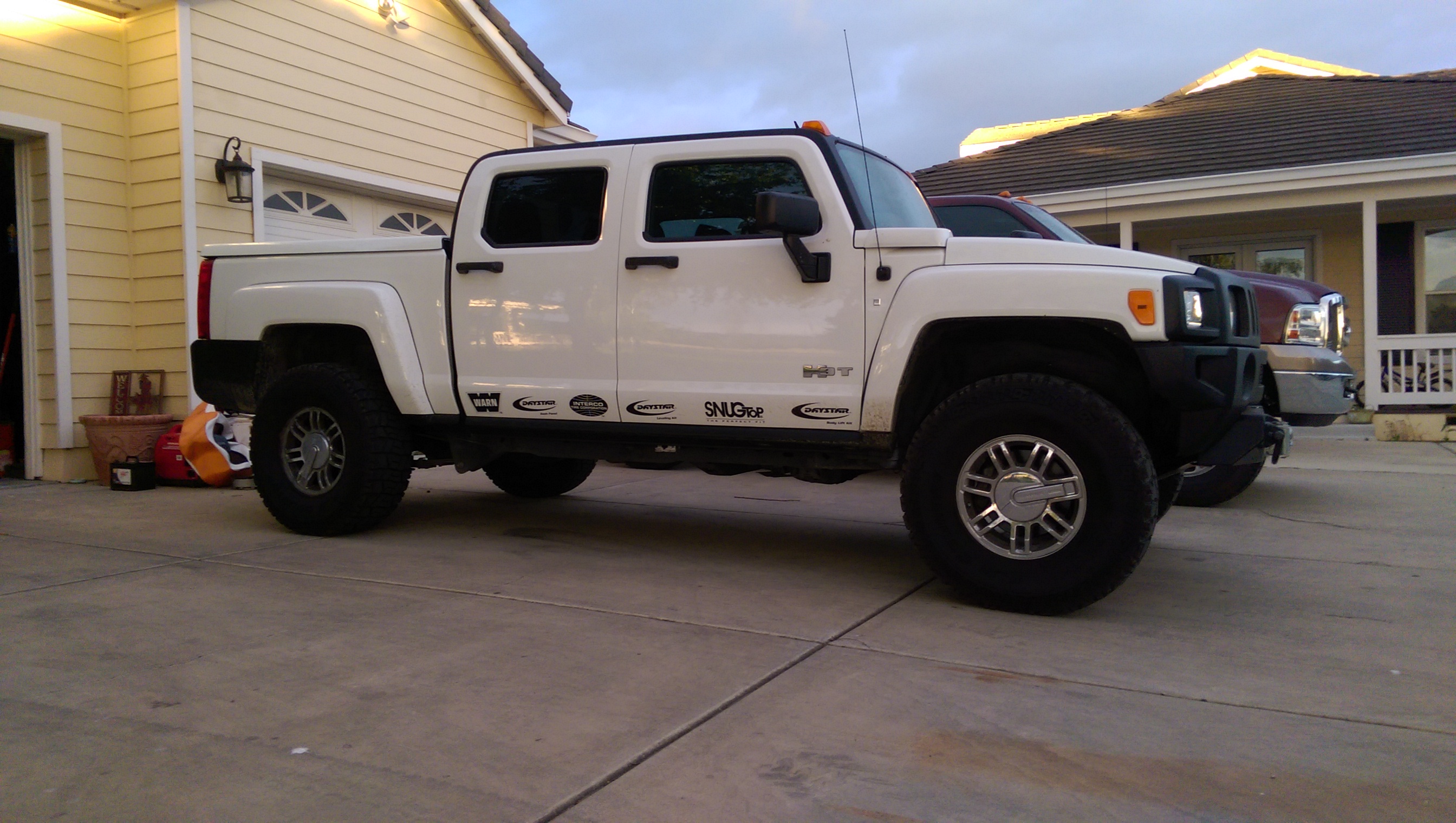

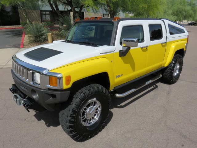

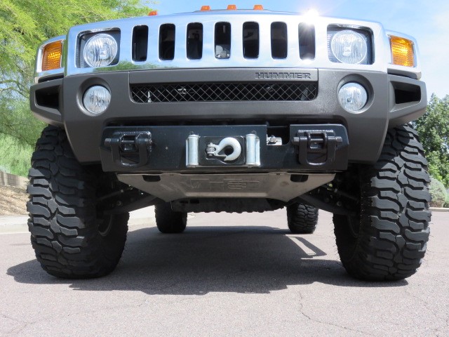

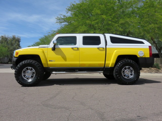

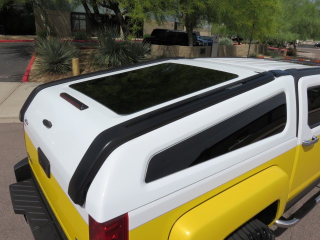

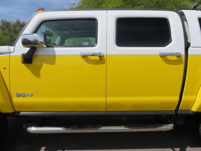

Just picked up an H3T Alpha for my Daughter's first rig. It was a SEMA truck for Daystar. I'm not big on the body lift but whatever, it's getting hard to find a white or blue alpha with low miles. Anyone interested in the Slant Back Snug top let me know. Not big on Yellow, but never know it might grow on me.

Looks great. I bought a yellow H3 used,and I said I would never buy a yellow truck, But it has grown on me and you can sure see it coming. But it was the best H3 I could find that was in very good condition.
Old Jun 4, 2015 | 06:25 AM
Hello, the body lift is on there to clear the 37" tires. As a T owner with 37s I would suggest getting a new steering rack mount from outfitter designs. It replaces the terrible OEM mount and also adds new poly steering rack bushings. Makes a world of difference!

Thank you very much guys. It's probably already all jacked up from them M-16. Wife picked it up in AZ and said they beat the crap out of her all the way to Texas. As soon as it gets back here to Cali I'm throwing the Toyo MT's on it I have. But thanks cause I knew I was going to have to give the rack and bj's attention.
Old Jun 4, 2015 | 10:01 AM
You will have to g with a 315/75R16 for the Toyos (35")
The only other 37" for a 16" rim is the Interco Irok NDs like I have.

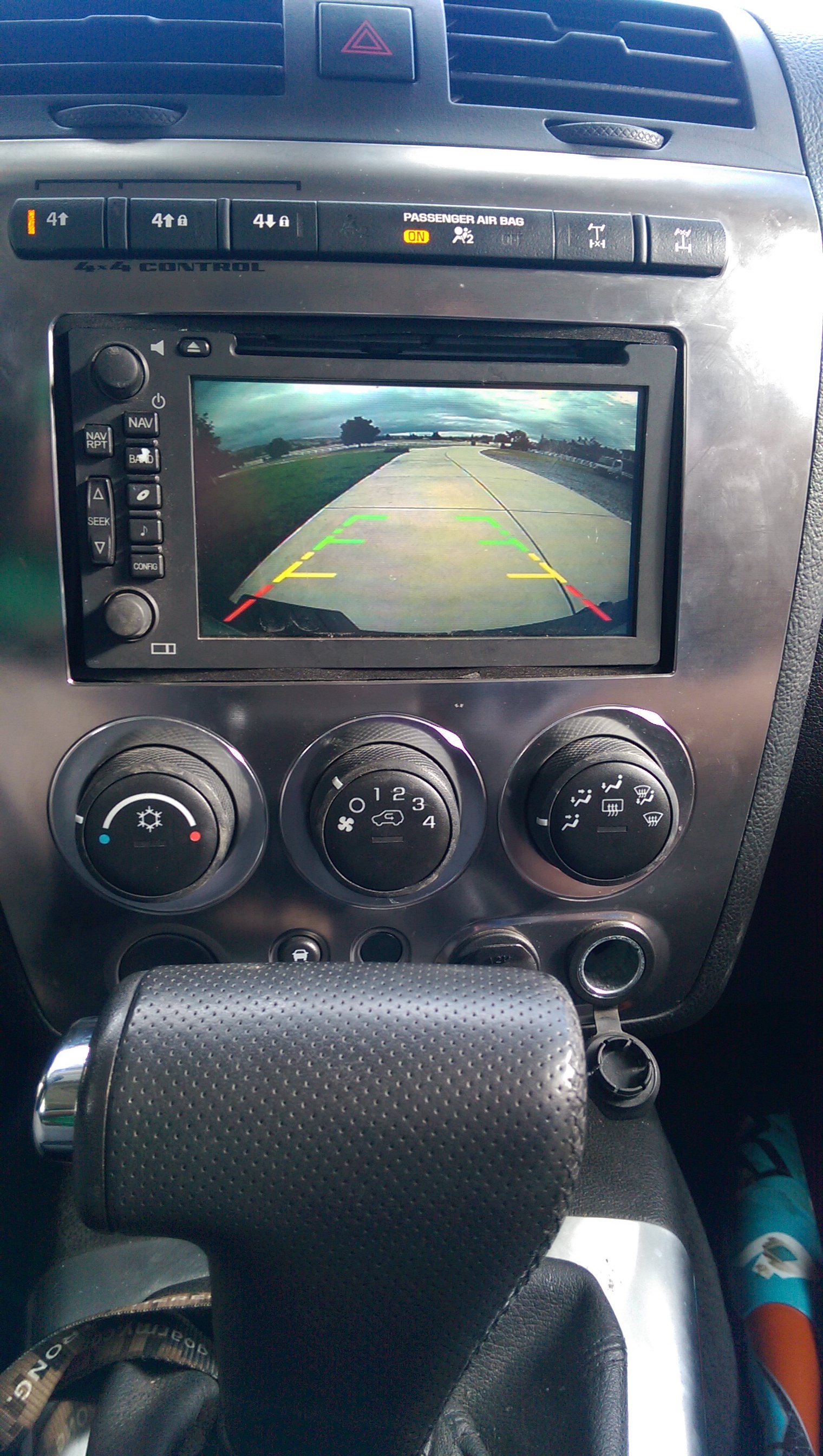

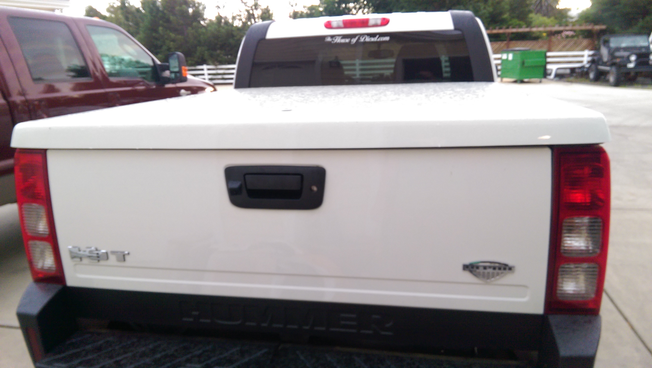

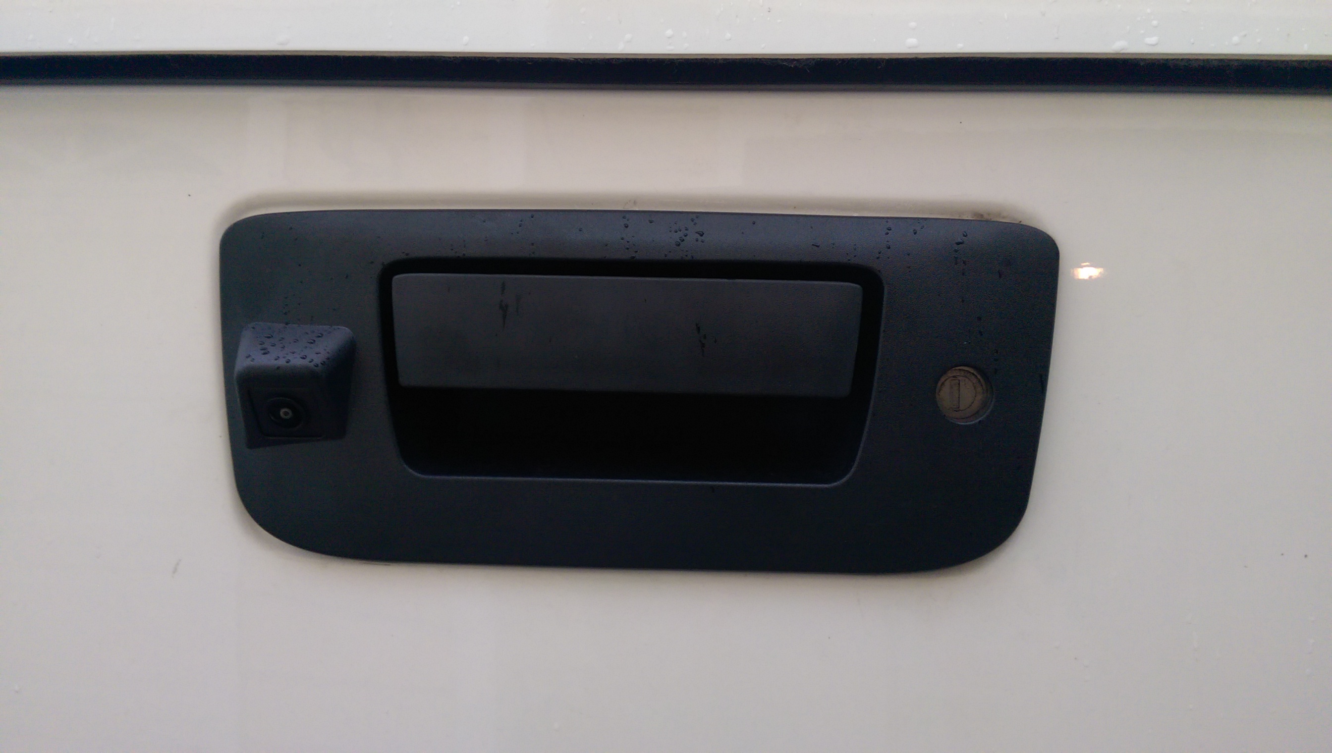

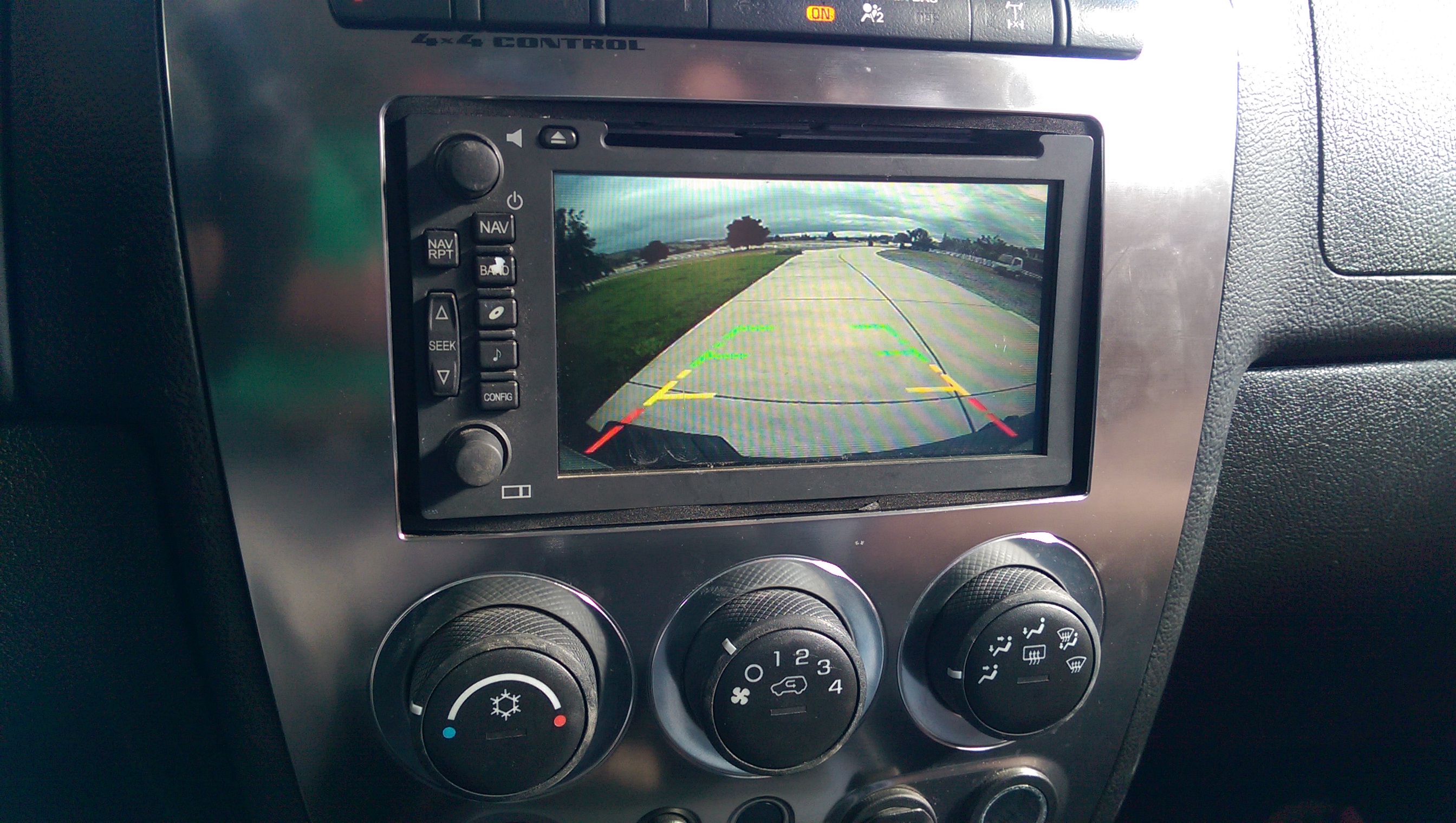

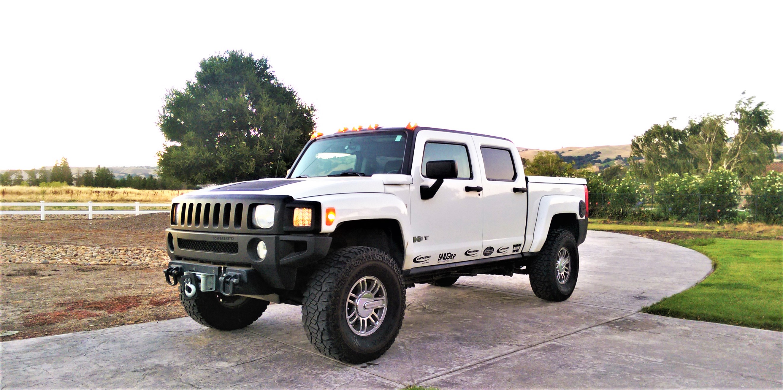

Well things change. Wound up buying my daughter a brand new Canyon Baby Max and decided to drive the H3T myself for a while. Just finally got the deck back from the stereo guy with the OE deck modified to except a backup camera. The tailgate bezel is just a hair different than a 2011 GMC Denali. Just one of the clips is in a slightly different location. The overall size and shape is almost a direct match so I had them use that to avoid them jenky license plate cameras and for it to look OE. Came out sweet. Now if I can just get the damn clearance light bezel that has been on backorder since NOVEMEBER of last year, I'd drive it every day. Sucks I finally have it repainted and dialed in and it's stuck in the driveway with the wiring harness exposed on the roof. lol I think I could have had a carbon fiber one fabricated by now.
Nav Tv modified the deck and the camera is factory GM for the 2011 GMC Denali. Definition on the deck is premium!

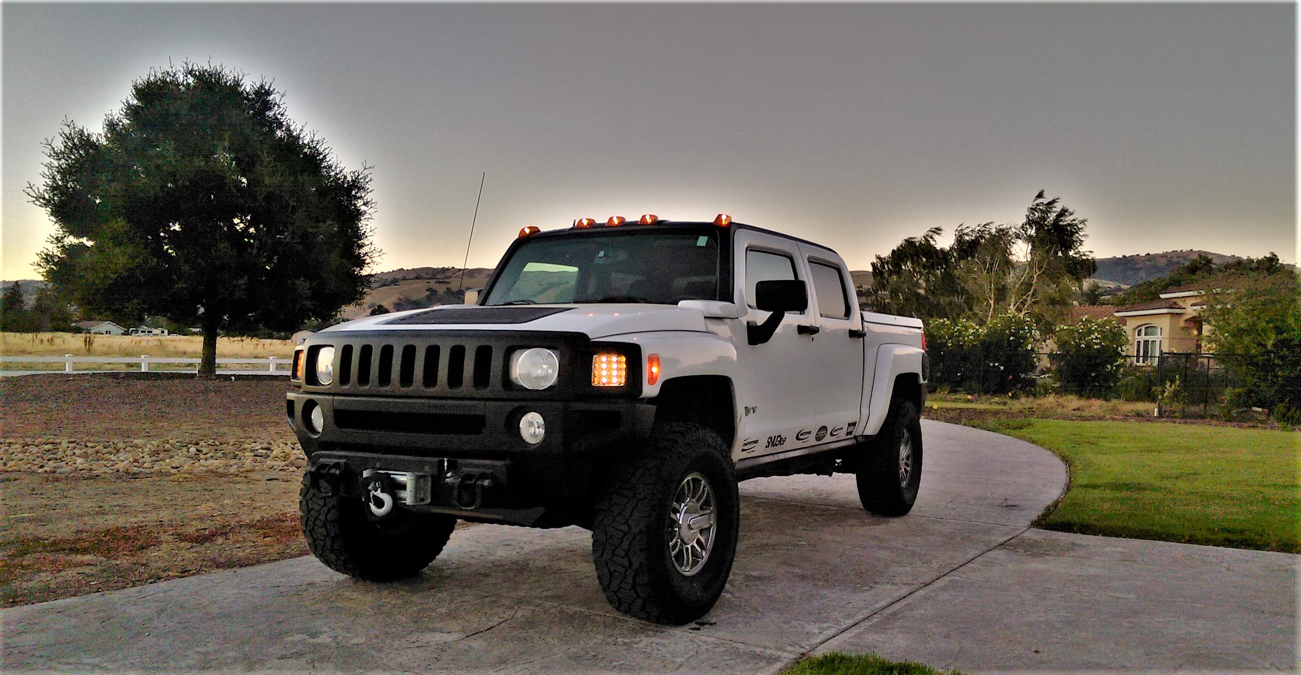

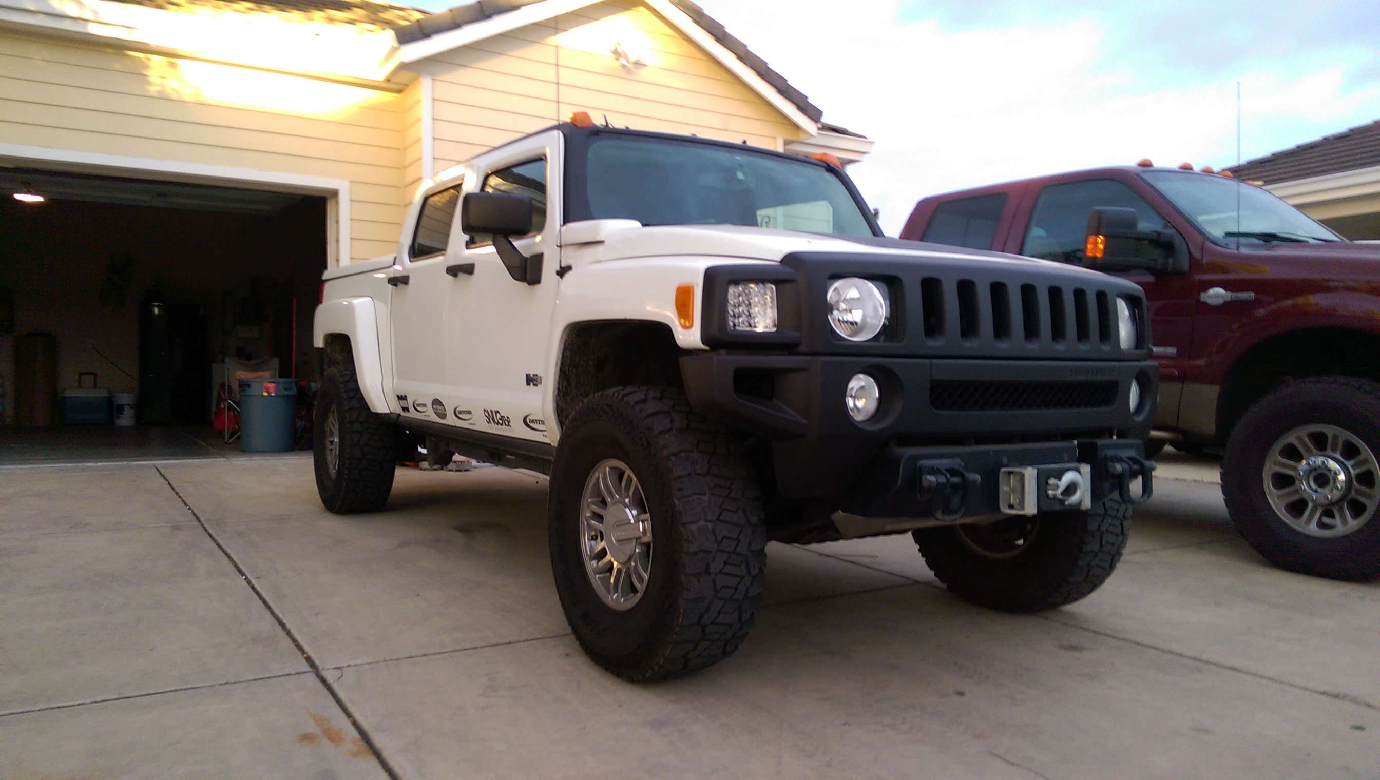

Paint came out sweet too. Was trying to wait for the clearance light bezel to take pictures of it. Back to the Daystar OE all white, but a blacked out all the chrome pieces. Looks much meaner!

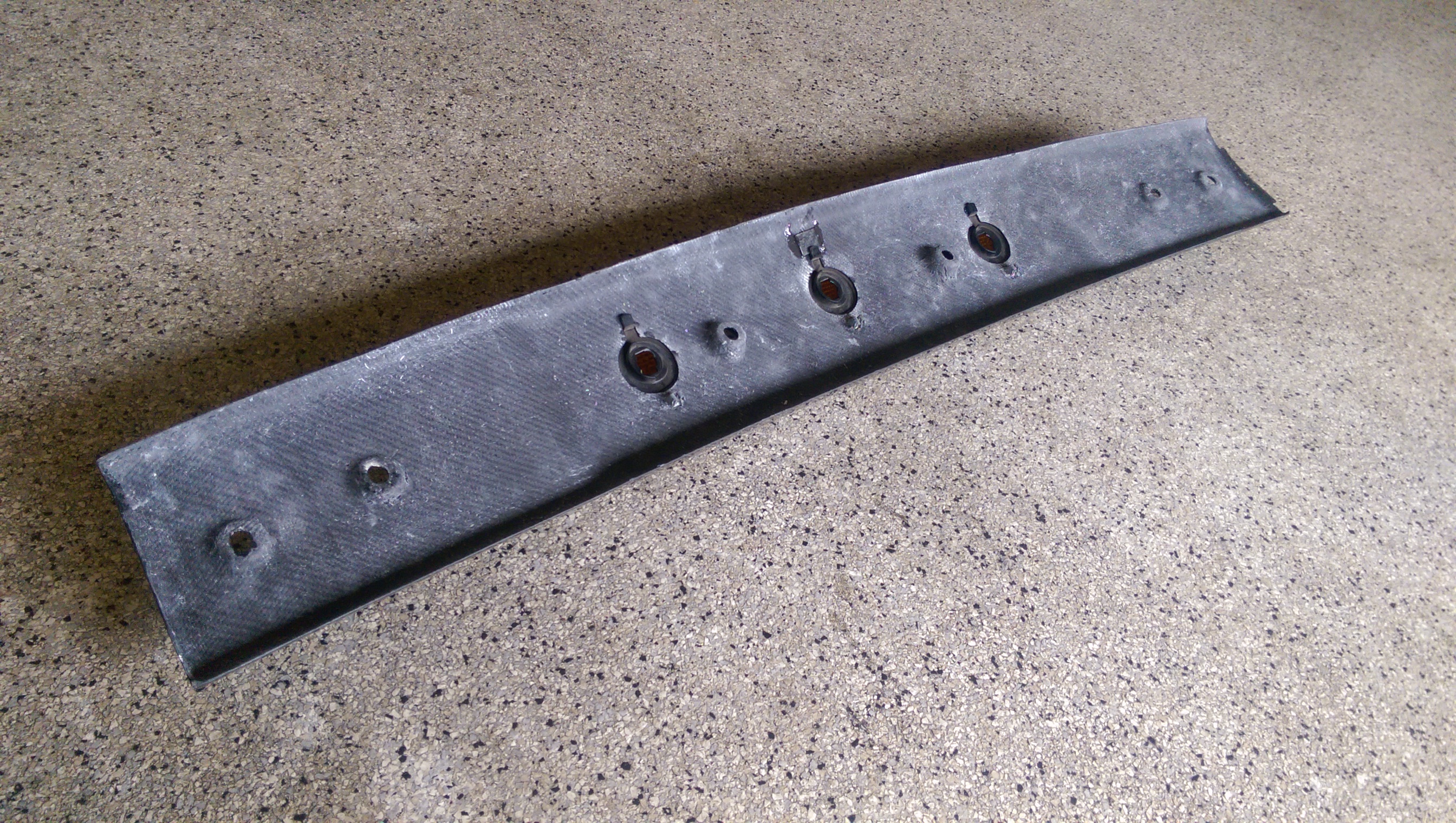

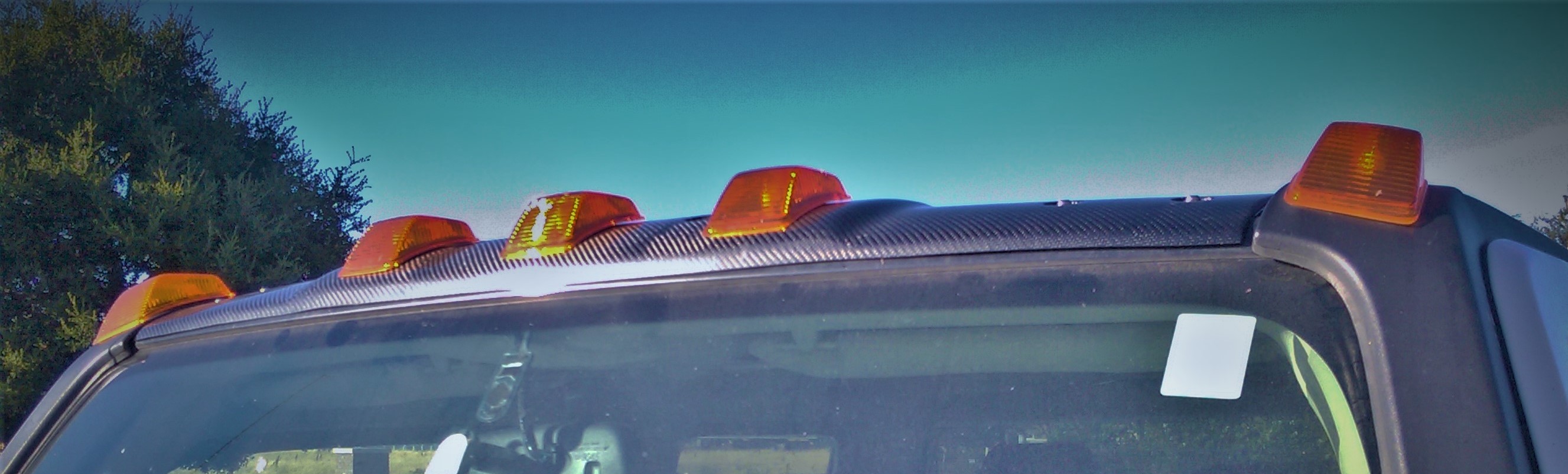

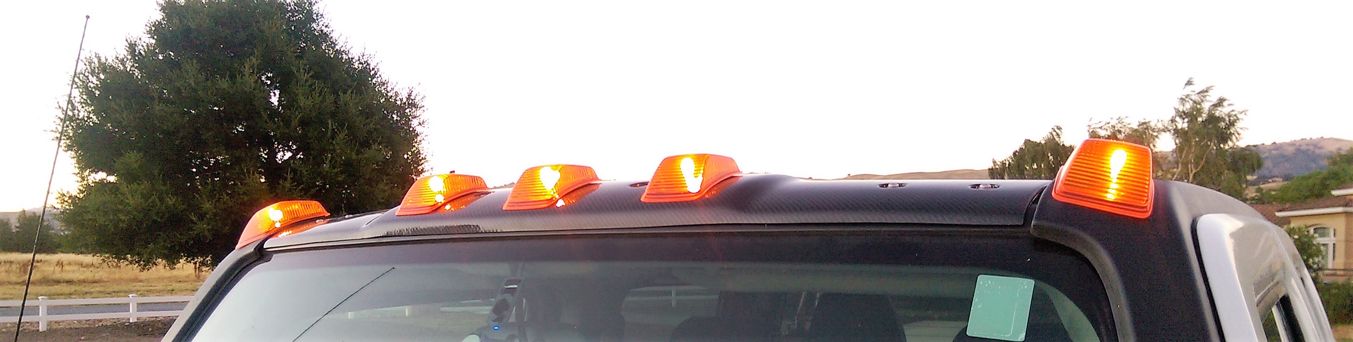

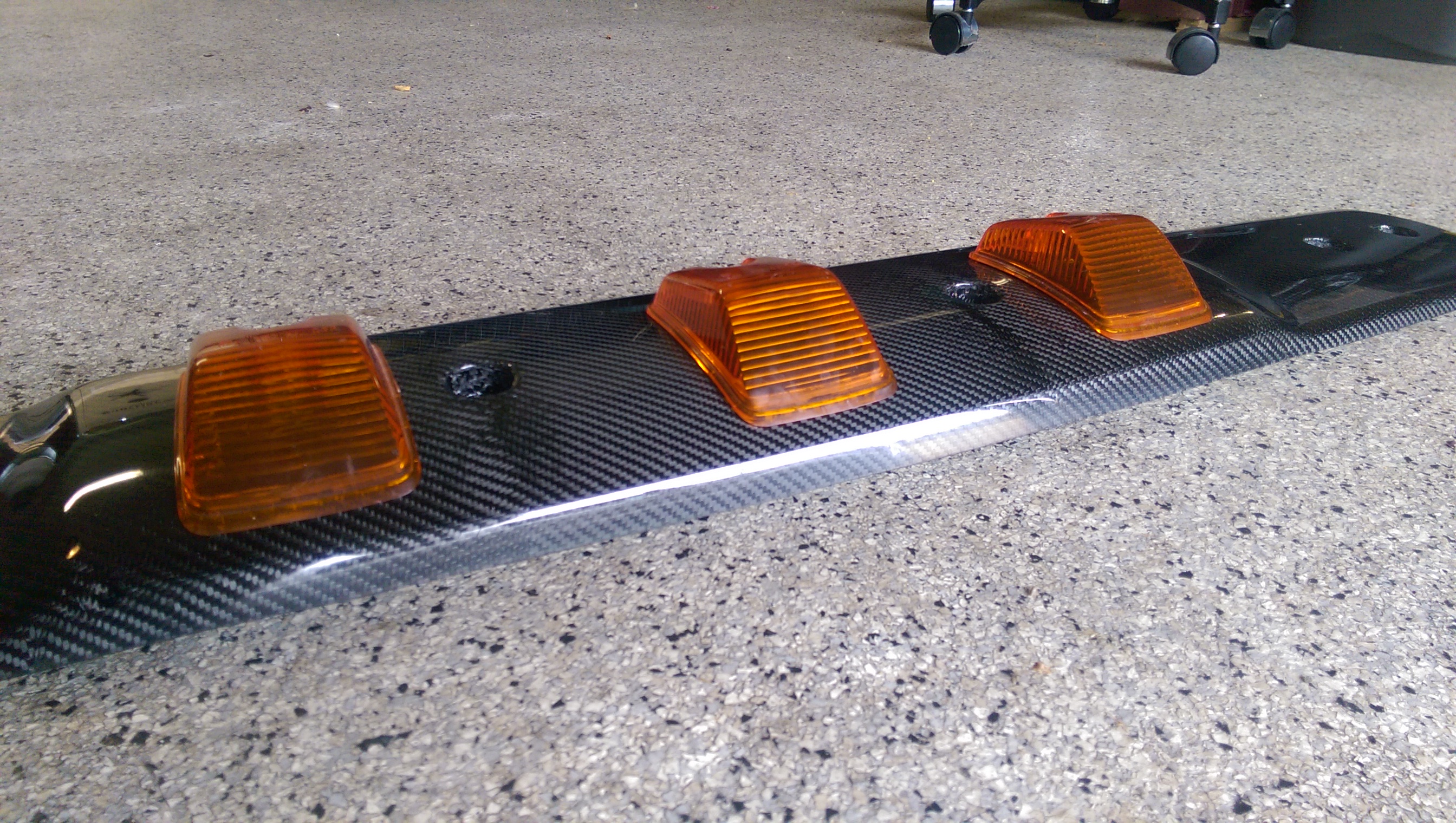

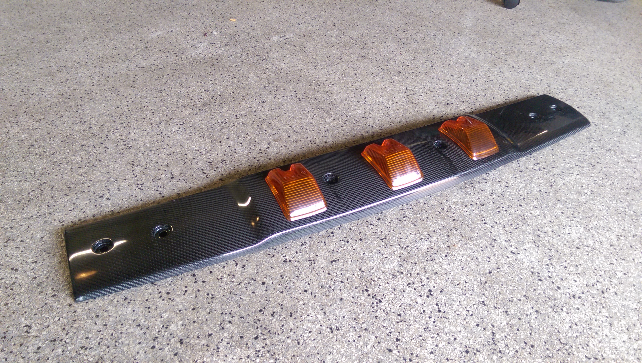

So I've been trying for over the past year to get a replacement clearance light cover built. Absolute pain in the ****! I've gotten everything from the 3d CAD files created to manufacture them out of plastic or aluminum and everything in between. I landed on having a replace created out of Carbon Fiber as to be stronger than the BS factory plastic and hopefully hold up better to the UV battering over time. I'll be looking to sell the negative to a manufacturer/distributor to hopefully open up the possibility for others to be able to get replacements since I got screwed by the only one claiming to be a source never delivering me the product after 2 years from Gstyle! Absolute crook and I'll never be doing business with them again. Hummer Parts Club on the other hand has been awesome to work with on every product that I've bought for our Hummer and have the best customer service in the business. Here are some pictures:
