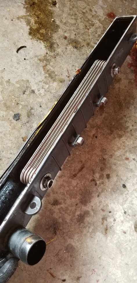

I learned that after inverting the radiator, you can take the bottom "end cap" off. I used channel locks to carefully pry the taps back one by one until I had worked my way around. I then found the transmission fluid cooler sitting loose within the end cap. I could then hold it in place (after replacing the o-rings on the outer line fitting) and thread them back into the cooler and torque them down. Then replaced the end cap, bent the tabs back into place, and was back in action! Every parts shop and dealer I spoke to said that that could not be done and that once the cooler dropped off, the entire radiator assembly had to be replaced.
Old Nov 13, 2017 | 12:08 PM
jryanantczak's Avatar
Joined: Sep 2017
Posts: 24
Photos of my solution
Old Nov 13, 2017 | 05:04 PM
happythree's Avatar
Joined: May 2012
Posts: 2,005
Default once a year award
the last guy showed us how to pull the alt from the top.
you are just as good!!
wish there was actually an award!!
NICE WORK.
wonder if i can replace the top cracked plastic from the old one i kept!??
i might try to remove it if its like your bottom...
the guys you talked to just never tried. today i called a gm dealer to see if i can get 2 radio , the same monsoon, to work in my h3. they dont know!!
