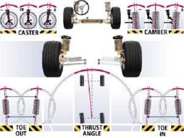

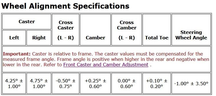

Hummerz posted some useful alignment information. Might be worth having that looked at along with a couple other things. Assuming the Kryptonite Tie rods are new, they likely aren't the issue. Next things i would look at is excessive play or movement in the pitman arm just off the steering box and the idler arm. Pitman arms are a common item to wear out. Another thing to inspect would be wheel bearings. H2's are notorious for chewing these up. Do you hear any grinding noises when you're driving at low speeds? While your at it, you should really just do an inspection of the whole suspension, make sure all of the rubber bushings are in tact on the sway bar and all the boots around ball joints in the control arms and such are not torn and the parts are not loose. I'm sure if you took it to an alignment shop, they wouldn't charge much if at all to get it inspected if you got an alignment too.
There are some companies like predator and Fox that make steering stabilizers for the H2. This is not a fix for worn out suspension components, but it does help with road manners especially with 37s on a lift. A little bit of "swimming" is generally accepted in a vehicle with large tires, hydraulic power steering, and the aerodynamics of a refrigerator as long as your suspension is not worn.
