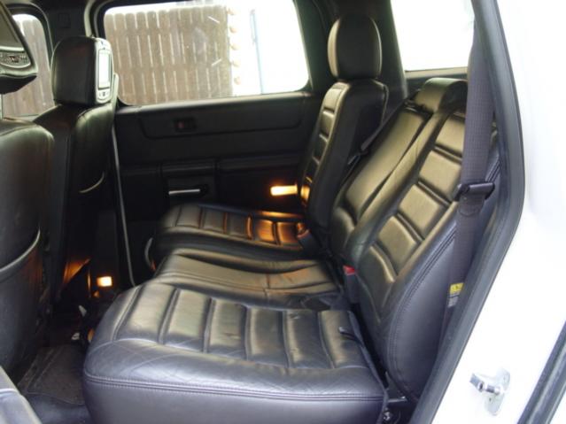

Hey everyone, I was searching to find a way to recline my rear seats (my kids now can sleep on long trips and my taller passengers that sit in the back ....their heads are not close to the ceiling!)
I found and bought a set of custom made seat hinge kits from these guys and they work GREAT! http://www.hummergearsales.com/index...0eit11oaankt42

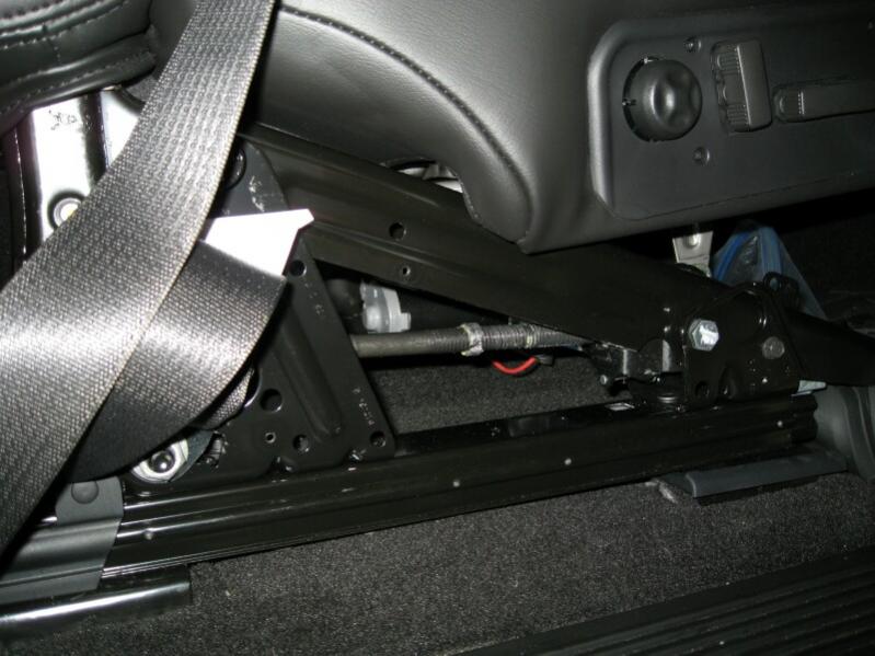

Here's a great free recline mod for the front seats.. C&P from another forum:
When you take the cover off move the seat so you can see how it works.
the collar is a position stop.
This will take you about ten minutes.
1. take off the lower seat side covers, 4 screws, move the seat up to make it easier to remove
2. cut the "collar" on the worm gear (ONE CUT) with a dremel so it has a break in it (looks like a "C" instead of an "O")
3. use channel locks and twist the collar back on the worm gear.
4. replace cover.
5. get laid, Carry surfboard, long lumber, fishing pole, etc
6. it is reversable to the stock setting.
Here is a pic with the cover removed. The screw is just above and to the left of the red wire...

S_C,
From that picture that looks like a front seat recline mod. This thread was about the rear seats reclining, but still good info.

Another friend of mine saw my seats recline and wrote them. They now keep them in stock and are selling them for $325.99 with free shipping. The guy is very nice (can't remember his name but it is different), here is a picture of mine...... I wrote him at sales@HummerGearSales.com
Oh! And they sell a License Plate relocator with light. It goes on the drivers side rear bumper.
