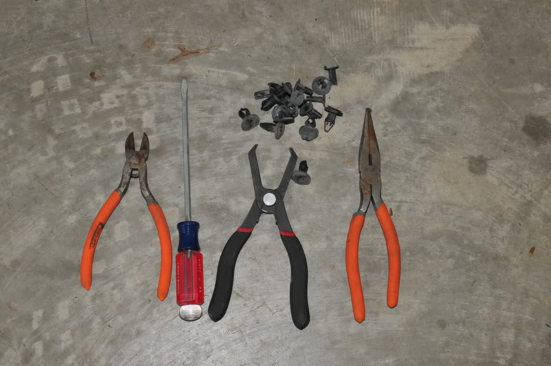

I found some at NAPA that are Balkamp 655-2388. They are the short ones that can be used where there is only one layer of plastic. I later found some longer ones at a Crow-Burlingame "Car Color" store which is the auto body division. They are AutoBody Master PM48782. These are probably the best in most places unless you find they are too long in some areas and will not pull the layers up tight. They have two slots in the head of the insert so if after you push down the locking button if you need to remove it they have some special pliers that will pull it up. Even with these you usually destroy them getting them out. The old school method is a flat blade screw driver, needle nose and side cutters. They will wear your thumb out putting them in. I used a dead blow plastic hammer on the ones I could get to. They package says they are for a Chrysler but my H3 doesn't care.
Here is a shot of my weapons of choice. Most will get mangled or break. There are also two bolts on the front fender liner.

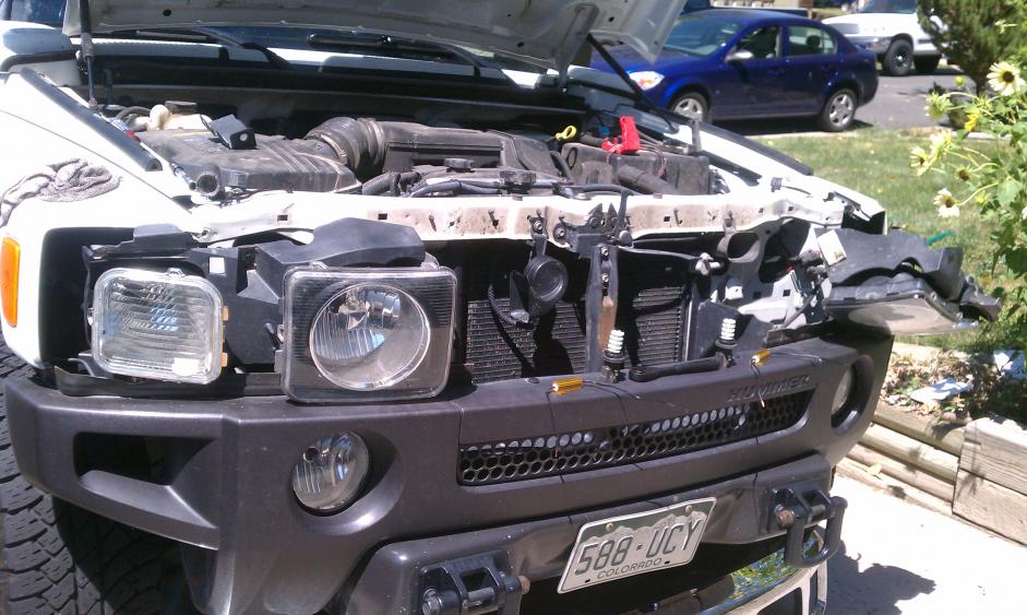

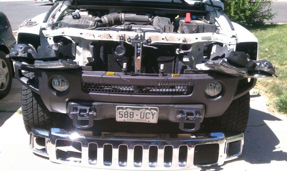

Thanks guys.. actually nothing to it.. very simple.. (6) 10 mm bolts to remove the grille and (2) 7 mm self tapping screws.. then (3)10 mm bolts on each headlight housing. (3) 7mm to remove turn signal housing. I didnt even have to unplug lights to get to any bolts. i will attach pictures with the switch back lights. I also have 5k HID lights for headlights from kbcarstuff.com and 3k HID for fog lights. i have clear side markers and white led bulbs on the way.. im also doing blue led floor lights and white led dome and cargo lights..
Attached Thumbnails How to remove H3 front turn signal housing?-imag0171.jpg   How to remove H3 front turn signal housing?-imag0172.jpg
