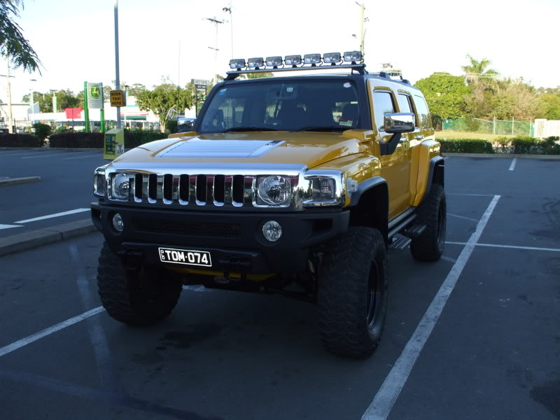

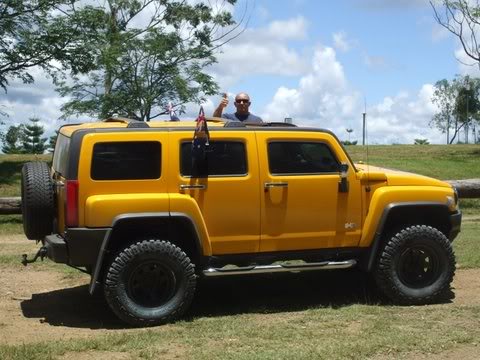

this is my ride that has a 4" rancho lift with about a 10" shackle and the front has been raised to suit which = about 6-8"lift
the tyres are 35" m/t baja claw

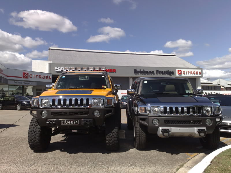

this is with the standard rancho 4" lift
and the 35" tyres
