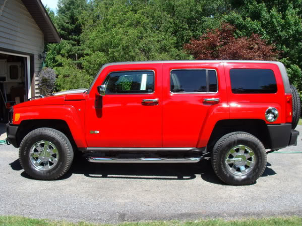

Here is what I did. Got the chrome cas cap and suround covers off E-Bay for about $35. Not the door like you are looking for, but just thought I'd throw it out there. Also I got one of the "Hood Grill Covers" that stick on over the black piece that is there, but the 3M tape sucked and the peice was warped and there was no way it was going to stay on at 40+MPH. So I bought one of the Real Wheels Stainless Steel Replacement Hood Piece. Just pop the black one off and mount this on. Here are some pics.
Before:
Size:  125.1 KBName:  PittsburghChildrensMuseaum2009040.jpg
After:
Size:  72.0 KBName:  H3004-2.jpg
Hope this helps.

The one that's on mine is easy to do. Took me about 45 min. The Drilling is of the 2 bottom holes (the top ones go through the OEM slots) and aren't in an area that you have to worry. Plus the piece has a sealer around the whole outside to keep the water out. But if you still want one that just covers and sticks with 3M, then they are on E-Bay. (saw one on there today for like $85) Like I said, the one on E-Bay was what we went with first. After trying to stick it down, I didn't trust it to stay. I found the one I have on now from a place online and it's great. No worries about if it's stuck on or not.
