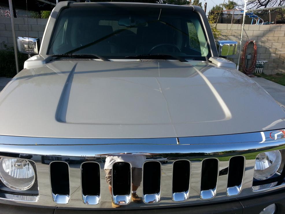

Leave it off, fill the holes, and either paint or plastic spray the color of your choice. I painted mine.
Attachment 7124
That really looks very good.
I never considered the plain cleaner look.
My louver was covered by warranty and glued down, but your truck
has now got me thinking.
