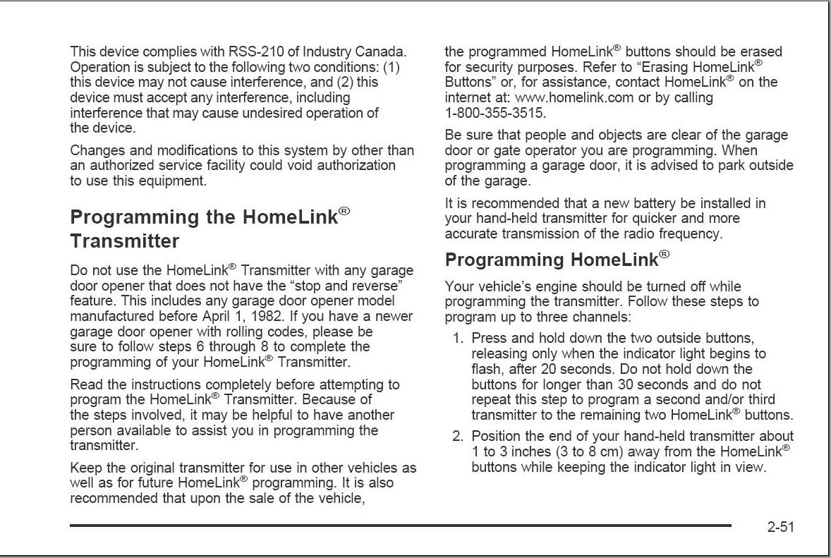

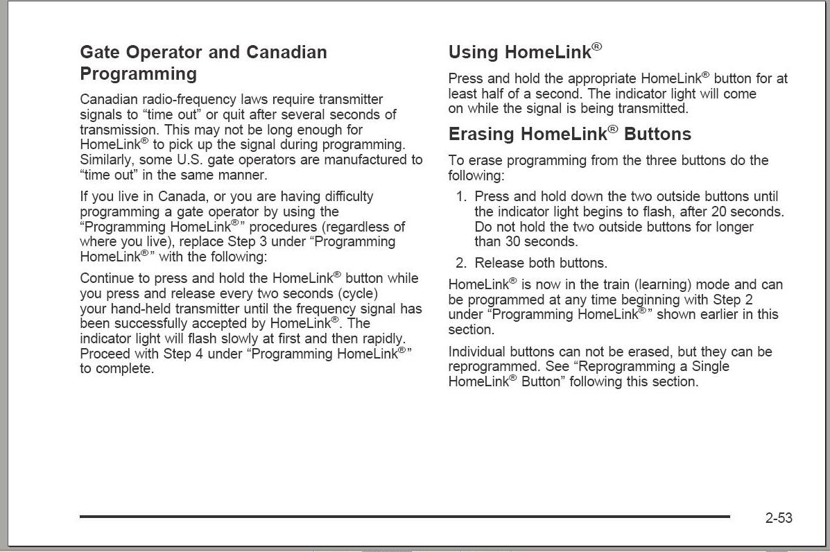

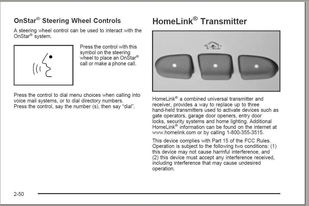

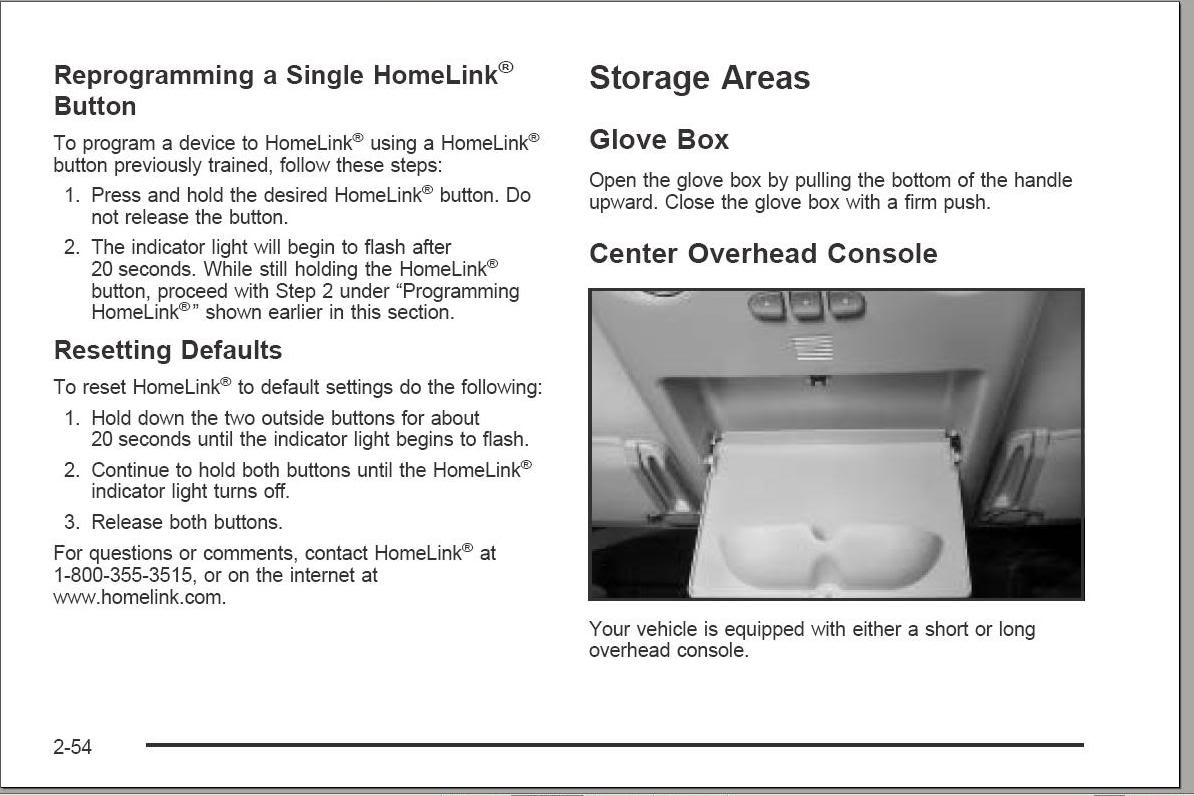

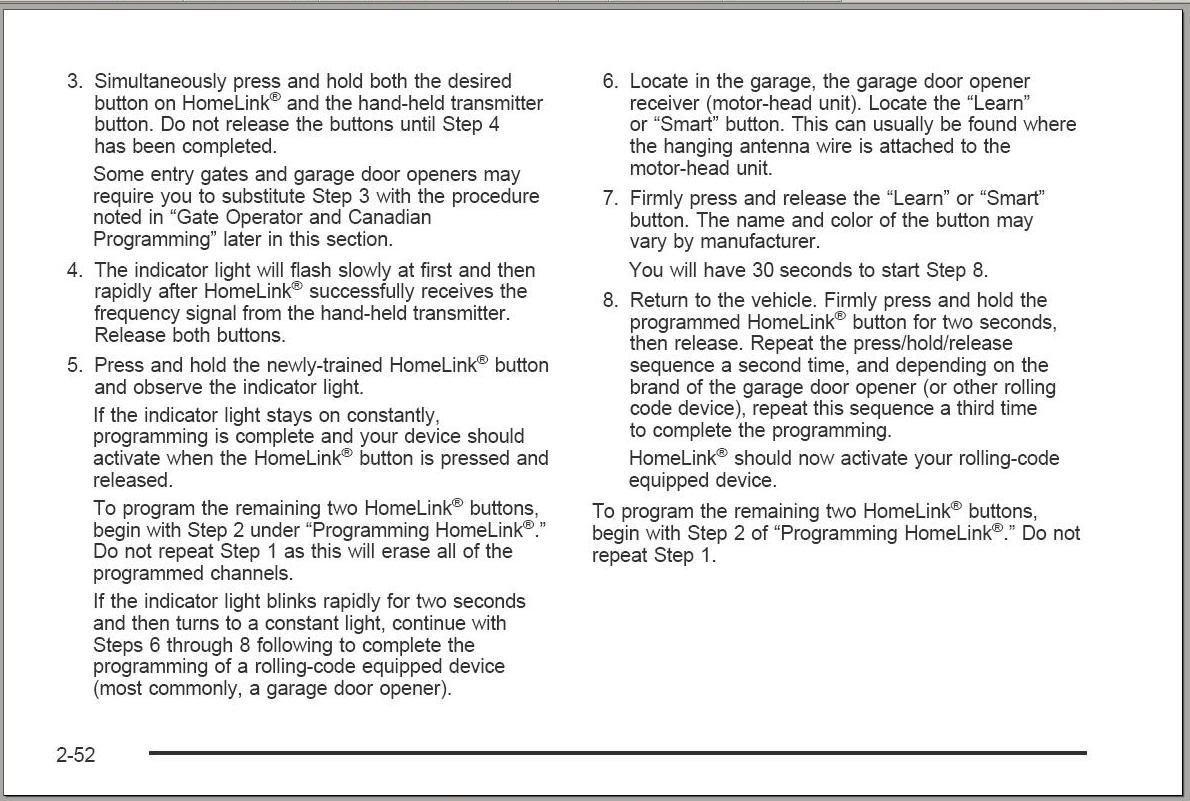

Nope, you just need to do the Canadian Programming in the manual:

Do #'s 1 and 2, then do the Canadian Programming, then go right to #4 and continue!!!

Make sure you do the step where you press the LEARN button on the opener itself!!!
