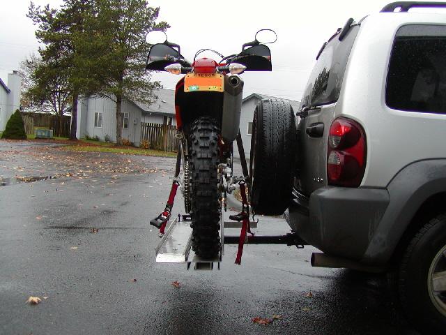

Default Sarge Industries Aluminum Motorcycle Carrier
This motorcycle carrier is made by a friend of mine. It might be a little more than you need but i figured since i've personally seen him carry a 400lb sportbike with it i would recommend it. Here is a link to the carrier, it is made of T5 Aluminum. If you mention hummerforums i'll see what i can do about a discount.
Sarge Industries Inc.
Attached Thumbnails hitch mount motorcycle/storage racks?-sarge-industries.jpg
