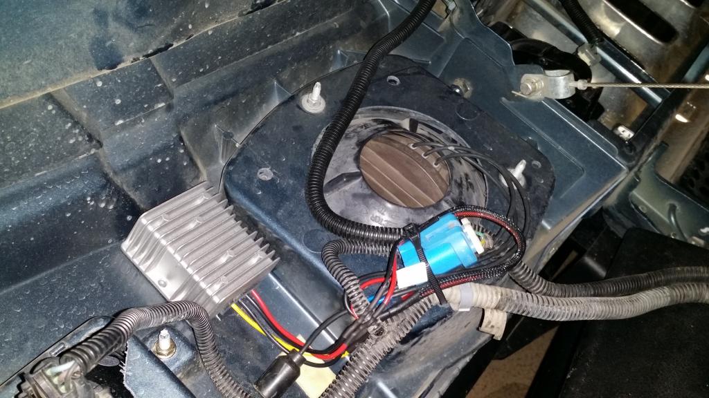

My headlights are 24 volt military lights given to me by a member of the forum. He had two sets and decided to give me a pair after a long convo about our H2's.
I believe any 7" round headlight should work. The headlight housing basically sandwiches the actual headlight between the two halves.
Here is a similar set of lights a forum member recently bought:
Amazon.com: Kuryakyn Phase 7 High Intensity 7" LED Headlamp Harley FL/ Metric 2249: Automotive
I cannot confirm if those will work or not, simply a reference to one of the products out there. Just search around for 7" LED headlights and you should get plenty of hits.
Unfortunately this is the only pic I took during the install:
