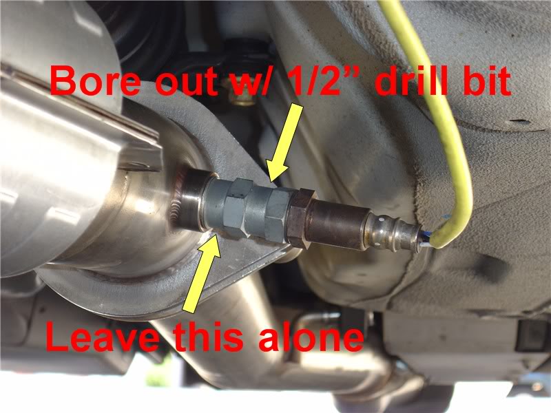

If you run the High Flow cats or racing cats and/or if you just got a P0430 or P0420 code you can get some spark plug anti-foulers from your local auto parts store and install them on the O2 sensor that is installed after the cat to eliminate the code. They usually come in a pack of two. You drill one out with a 1/2" drill bit and insert it into the one that you didn't drill out. Screw them into the O2 bung and install the O2 sensor into them. This pulls the O2 sensor out of the direct flow of the exhaust.
Attached Thumbnails hi flow cats-14321d1224480094-5-fix-5-spark-plug-non-fouler.jpg   hi flow cats-spark-plug-anti-fouler.jpg
