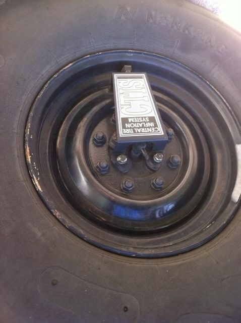

Here is the tire...
Please tell me I won't have trouble at the shop...

Old Feb 3, 2013 | 05:15 PM
Looks like a one piece rim but you likely still have run flats. How much does one weigh?

Those are the same kind of tires I had. If there is a run flat inside the local shop should be able to get the run flat off with regular tools. More than likely you have a two piece run flat inside, and the local tire shop will not be able to put them back in your new tire. Installation of the 2 piece run flat requires a specialized tool that is ungodly overpriced. Have you found tires yet? Those are 16.5 rims and tires are something else the local tire store will not have. Look on ebay.

@3hummers
I haven't had a chance to take the setup off and weigh, so I am not quite sure...
Is it worth it to do that though instead of getting to the tire shop only to find out they can't install my new tires?
@MattN
I already bought military surplus H1 Tires. Some Bridgestone MT/R's
I really hope they can install the run flat inside. If I even have run flats...
Is it really crucial to have them installed with my new tires?
