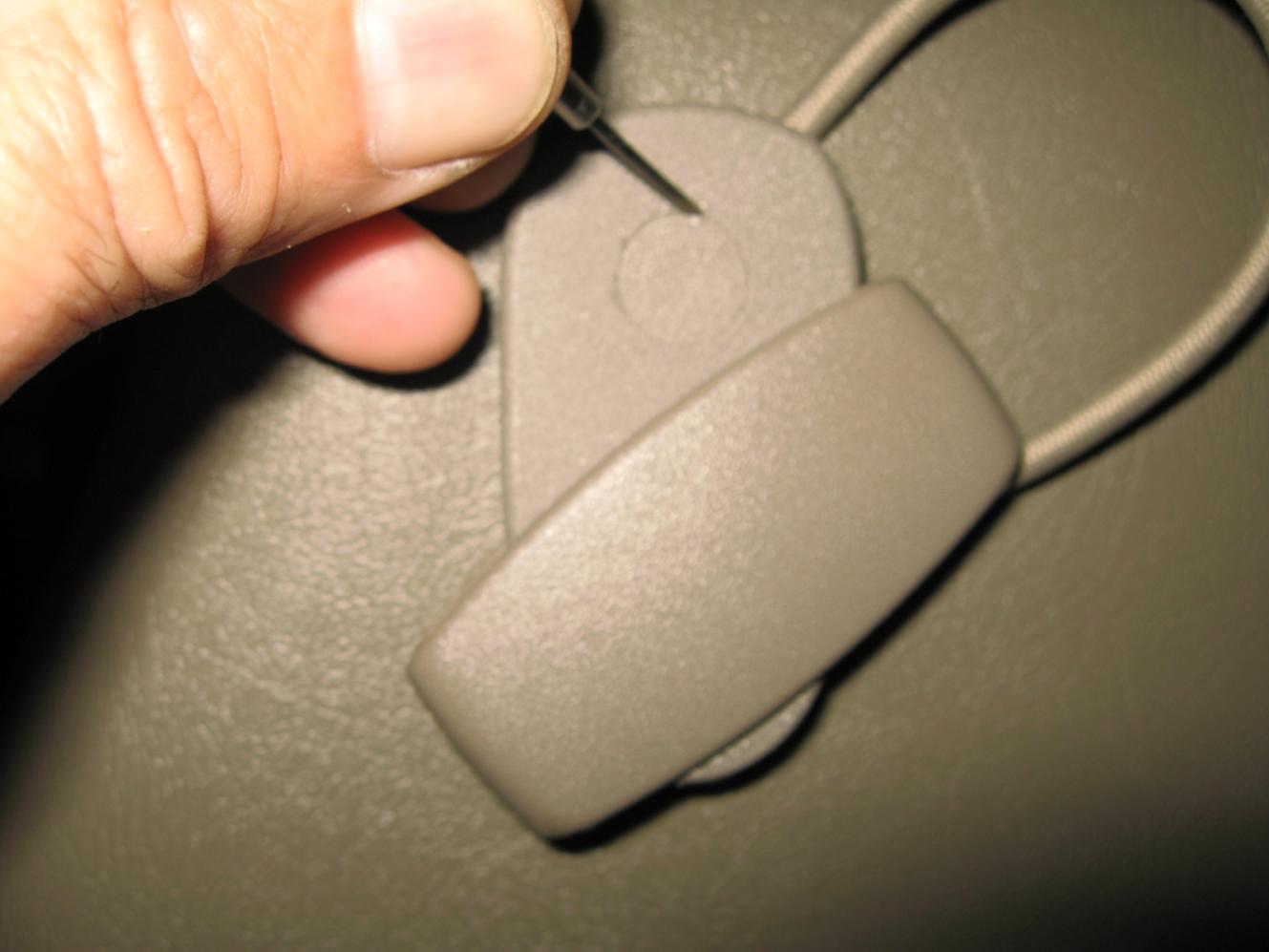

Take a very small screw driver and "pop" the round disc out, it is a push pin type fastener. Taking the old one out I wouldn't worry about hurting it but I just took mine out to see how it works. Pics attached, hope they help.
Ed

You Rock Man... Thanks.. another one down (at least when I get the part)...
