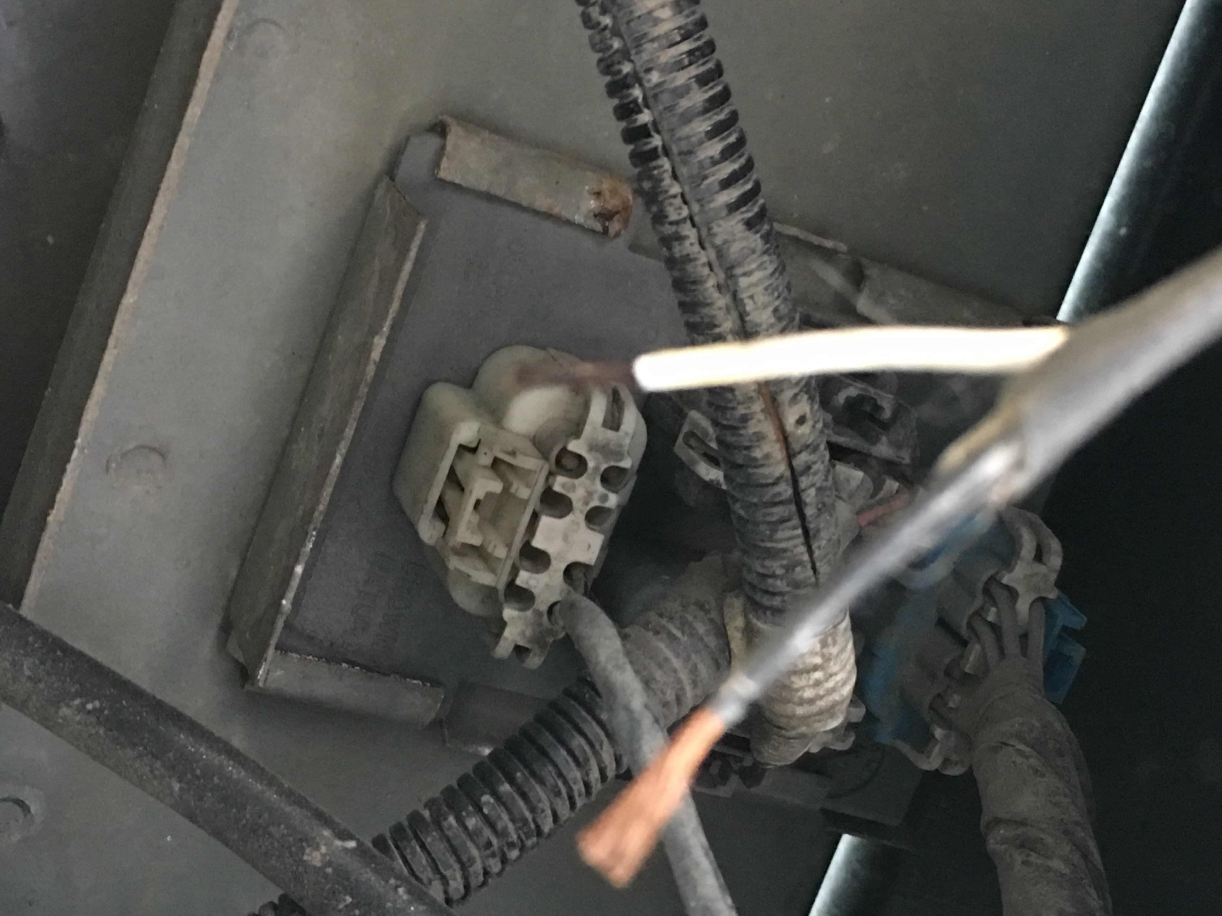

Old Apr 4, 2016 | 12:16 AM
Brandon C's Avatar
Joined: Apr 2016
Default Junction box
I took photos while wiring up my spare tire license plate light. Use an ohm meter, but I think white was ground for me.
