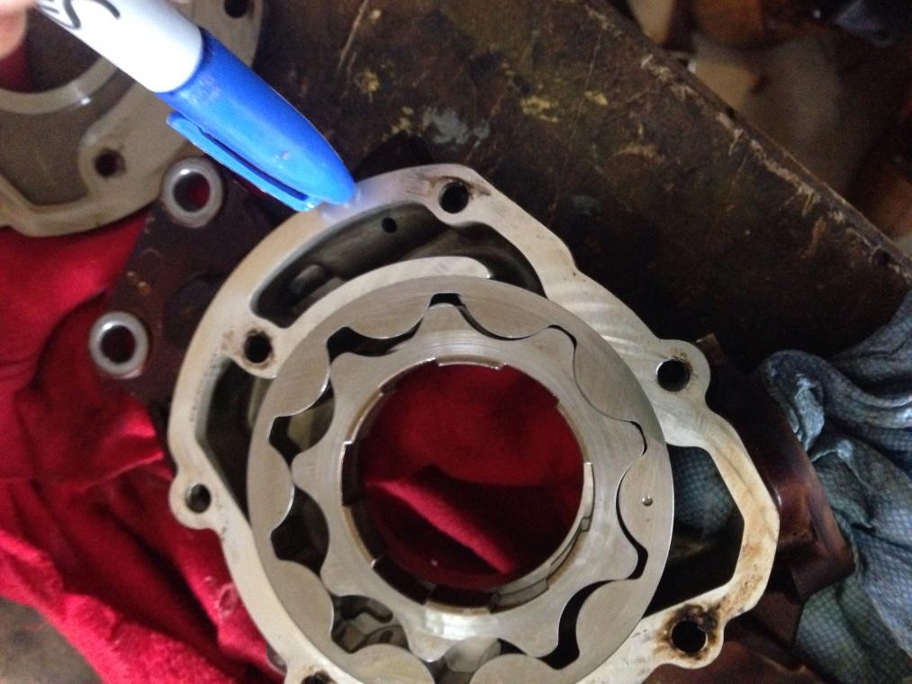

So I've had her back since Wednesday. I can tell just by the way the gauge acts now that it is fixed. Cost me 1800 with the initial visit to the garage. Just glad I didn't lose my motor or damage any bearings etc.
So for sh$tz and giggles I kept the old oil pump and took it apart to see if I could determine what caused the failure.
On initial inspection you can see that oil has baked on the outside cover indicating that the PO was full of sh$t about his stellar maint.
So I popped the cover off. Spotless in here and the gears mesh nicely with no metal shavings or debris.
Then pull the Allen bolt for the relief valve. Not so clean in here. Pull the piston out and immediately find chunks of debris and scoring on the side of the piston. Also found a score and bur in the cylinder wall where the piston seats. The debris appears to be hard sludge.
The moral of the story is change your oil frequently. The ports on the valve are very small and it doesn't take much to clog them. These things are prone to failure.

For some reason I can only post one pic at a time
Old Nov 16, 2014 | 10:22 AM
madmayo's Avatar
Joined: Mar 2014
Posts: 356
From: Belwood,Ontario , Canada
More pics
