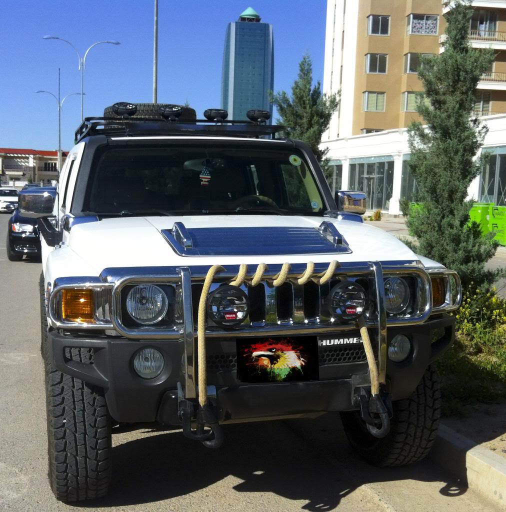

after i returned from Off-road trip of 80 Miles and some fun in river 6'' water height today when i started the car and shift to D its Hard shifting and i don't no why then i see the MIL with the only code present
P0717 input/turbine speed sensor A circuit no signal
help me to Diogenes this code please , where is the Sensor located? do i have to change the assymbly or the sensor or what should i do
Hummer H3 2007
VIN: 5GTDN13E478184220
Year: 2007
Make: Hummer
Model: H3 Base / H3x
