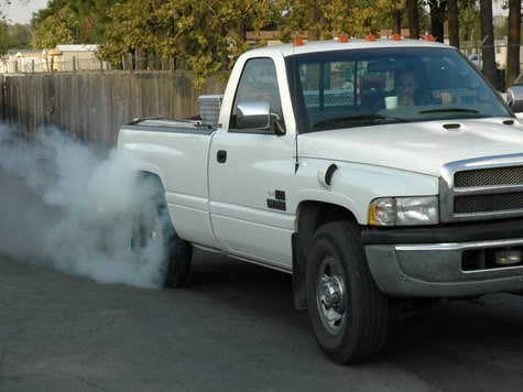

I have a two scoop hood on my Cummins but ended up blocking them off except heavy towing in hot weather. I did raise the boost from 18psi to 38psi on the turbo and caved in my stock air box lid. I installed a scoop with a grill in it and it has a space between the fender and engine liner for solids and water to drop out. It can be blocked off in bad weather. It keeps the EGT down some and helps the diesel breath while heavy towing. I also bored a 4 inch hole in the fire wall just in front of the windshield that goes to that high-pressure area under the wipers for more intake.
I'm not really a "fan" of running open intake scoops all the time as they scoop water and "stuff" but could force some heat down and out despite the tendency of heat rising.

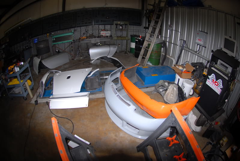

This was one of my biggest projects awhile back. All carbon fiber pieces. It was to have a final wrap covering it all so I just shot the parts with whatever white I had and the orange just to mess with the guy when he was slow to pay. The guy moved off to California before I got to see the wrap.
Anyway I look forward to any attempts to build one for the H3 and ideas you come up with.
