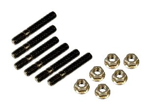

I'm another guy who, this weekend, is replacing his cracked exhaust manifold and pulling out at least 3 broken bolts. For those who have removed their broken bolts, what are you replacing them with? Stock bolts again from the dealership? Or something different....
I suppose you could get em from the dealer... Buut I'm sure they'd hsve to order them amd charge you god only knows how much for em. Or do like I did and go to your local hardware store and get some grade 8 bolts for just a couple bucks a piece.
Oh, and put some anti sieze on em before re installing incase you ever have to take em back out for some reason.

Thanks Bruce I will. Do you know size and length? I haven't pulled any yet and would like to be prepared by the weekend.

Posts: 9,043
not just any antiseize (copper) high temp
dorman 03133
http://www.summitracing.com/parts/rn...ummer/model/h3

Thanks HummerZ. Although I hope I never need to take this manifold off. :-]
So one more question, why 6 bolts? I already did a search for them and saw this kit, but didn't pull the trigger because I have nine holes in the new manifold. Again, I have not removed the old manifold. I only have the new to look at, but it appears there are more holes than 6.... Are the lower 3 a different size?
