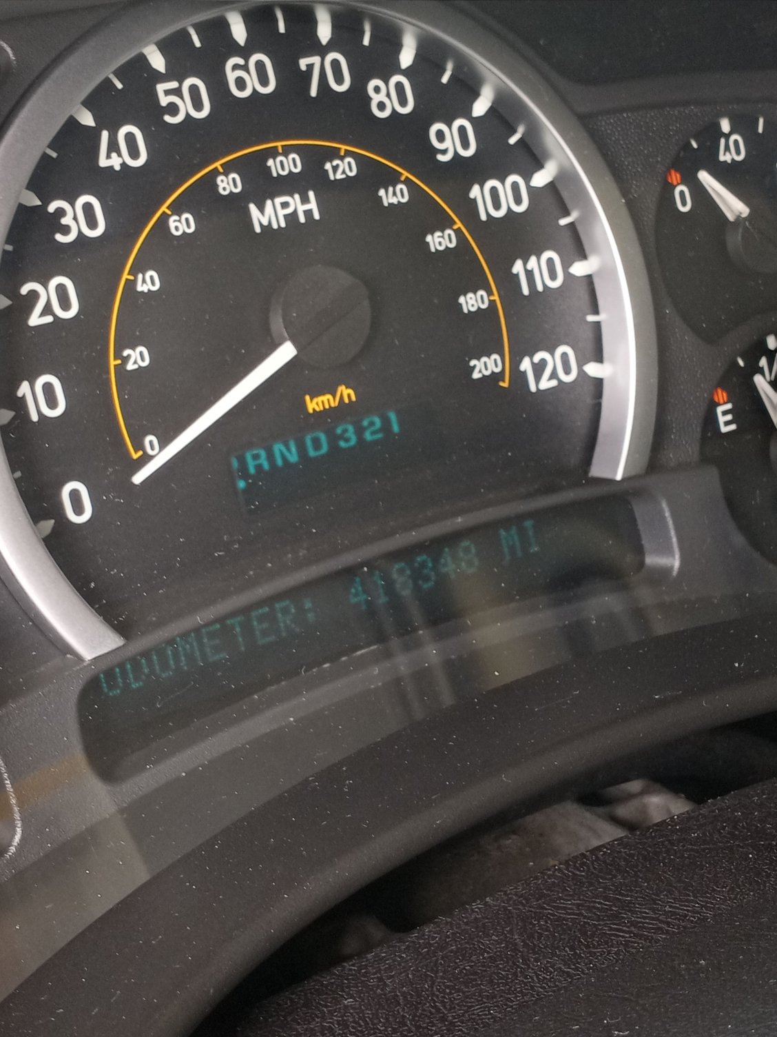

Current mileage

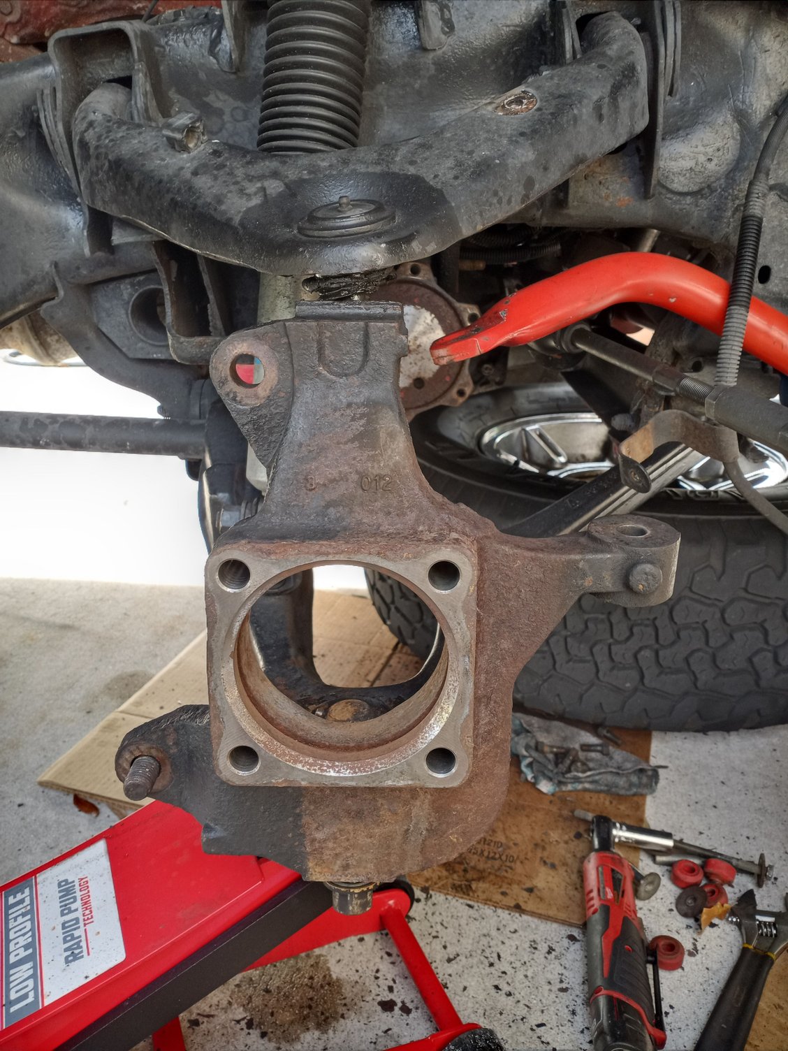

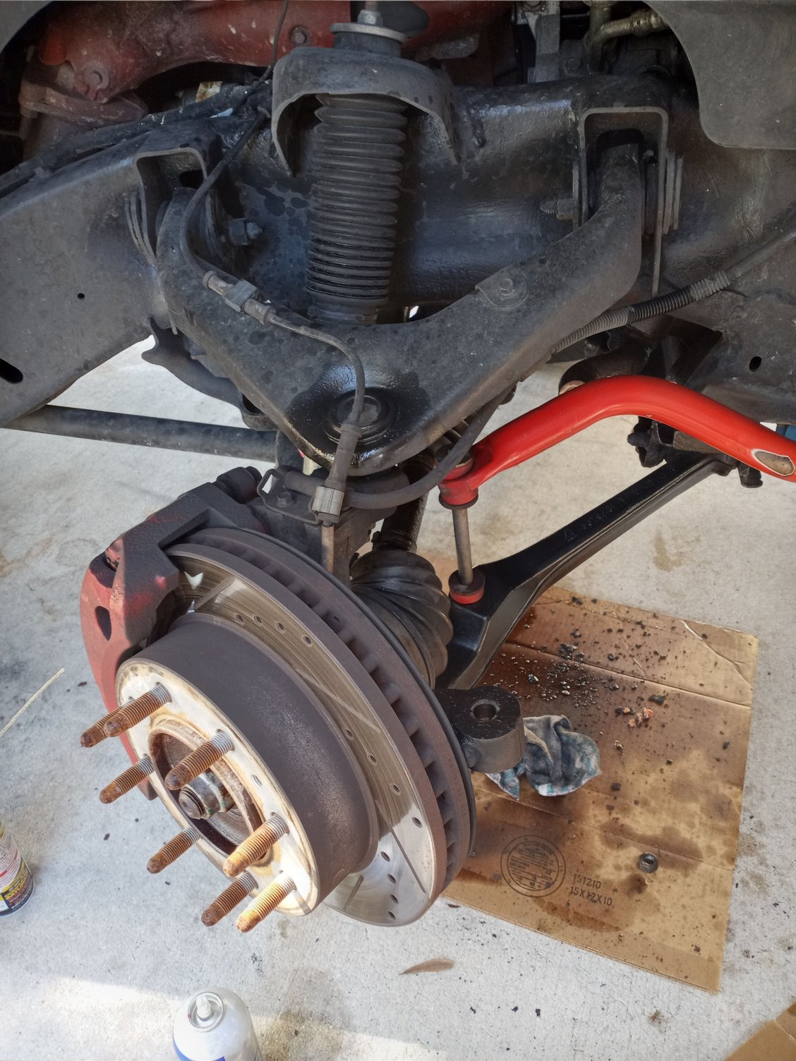

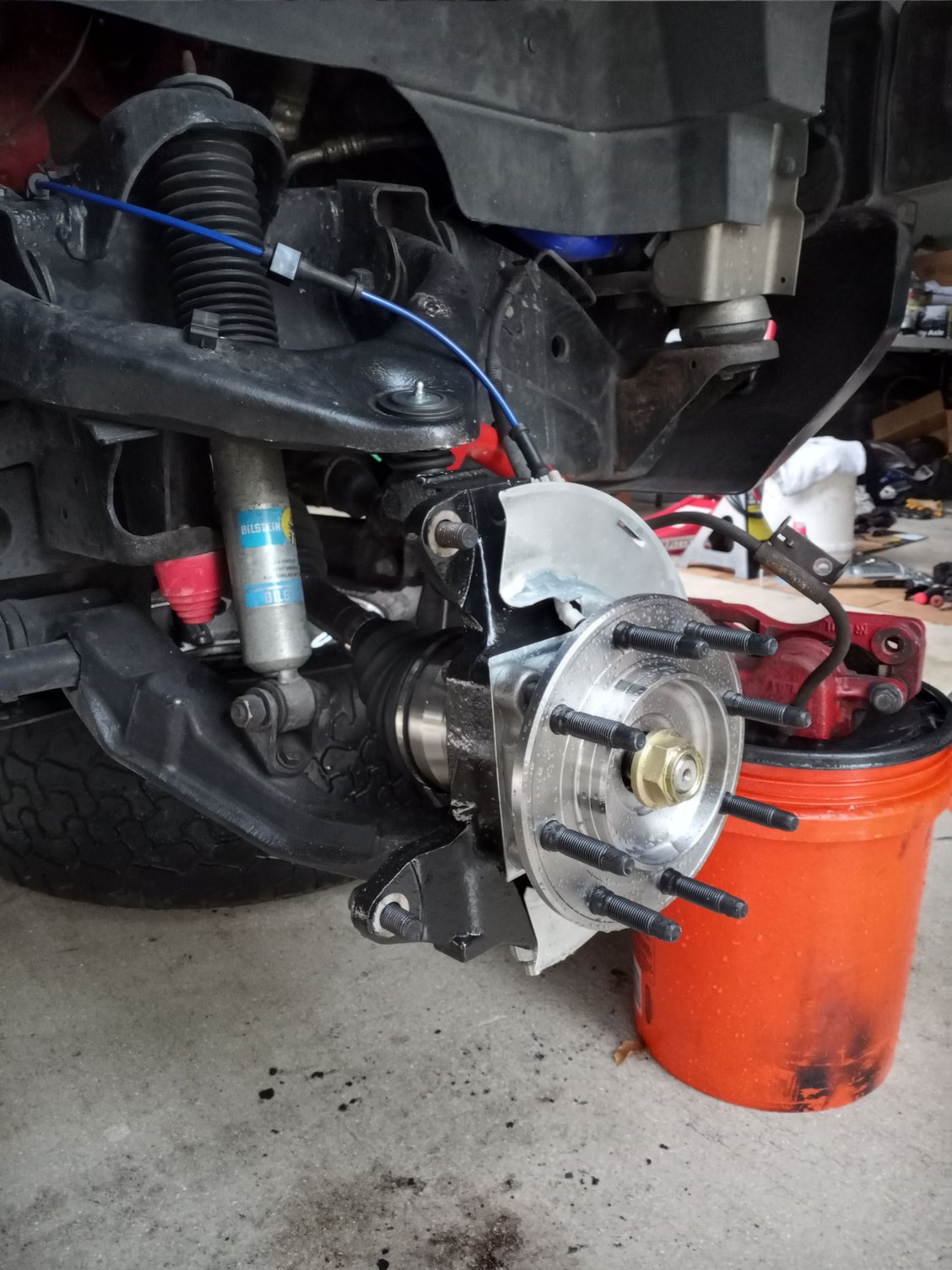

Quick update, passenger side only: managed to get the upper and lower ball joints out and installed new ones, this was by far the hardest thing so far as far as work. Took a few hours but they popped out. Also took off the cv axle, wheel hub and the steering knuckle. As soon as I clean and paint the steering knuckle, new cv axle, new wheel hub, new brake dust shield is going in. Repeat on driver side around Tuesday as I'm still waiting for a few parts to come in.
That was a fun 3 day weekend working on the truck. Few pics.
before tear down

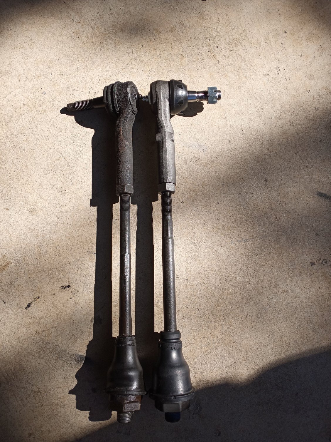

New tie rod
These gave me a good fight
Out with the old and in with the new. Removal was fairly easy.
Almost done cleaning the steering knuckle. Paint next. And reassemble time.

Assembly 95 percent complete on the passenger side. Just need to torque the cv axle nut and run the wire up to the connection point.

Nice work. I was looking at getting those Dmax tie rods when it’s time to replace mine. They’re huge. How are the Bilsteins? I’d like to get a set.

Either way its impressive and shows what solid maintenance can do but that pic shows 418,348 Miles, is it miles or kilometers?
