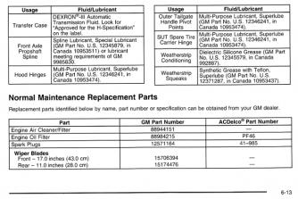

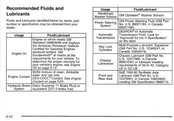

Here's a couple of pages out of my 2005 H2 manual that will answer a couple of your questions. I had to have my seals replaced. It was covered under my extended warranty so the dealer did the job. Glad I had the coverage. The dealer said it was a $1,000 job.
[Edit] After posting the images I can see this forum has reduced the size to the point where they are almost impossible to read. The originals are twice the size and easy to read. If anyone has a better solution (short of typing all the text) let me know and I'll give it a try. [/Edit]
