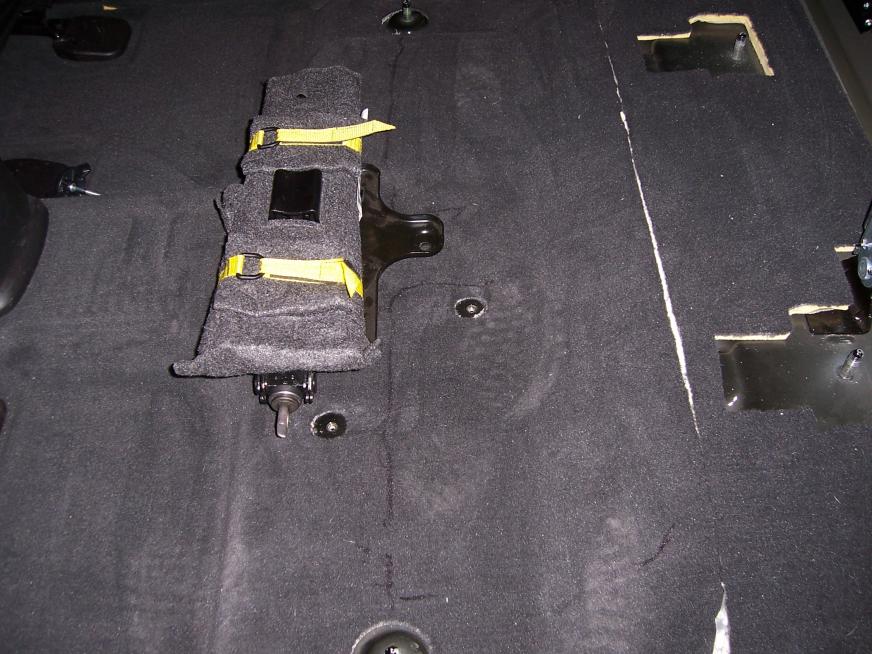

Eurica! So I have found a product for the rear of H3Ts. It is a Kicker Hideaway which includes an 8" sub and 150 watt RMS amp in one small package. It also has a manual dial to turn it from 0 to 11, for energy, or when you don't need any bass. Cost is $300 bucks, but with these trucks, there are VERY few options. This will fit under your passenger rear seat just by removing the jack. It fits with no mods at all and can be wired to any factory system. I installed two, which required to remount to jack a few inches forward. I also cut some foam out of the top of the hump for more clearance.
I just did this install and I have not yet wired the system up. With that being said, all of the product reviews on this sub have been great and I can't wait to hear the sound! No stereo companies had a solution for this tiny compartment to add a sub, other than a custom fiberglass box, plus subs, plus amp, for big money.
Also, if you make a custom lock for your jack, there is no way to get this box out! Without removing that or the rear seats, it would take a huge pain to steal. After install everything looks factory stock.
