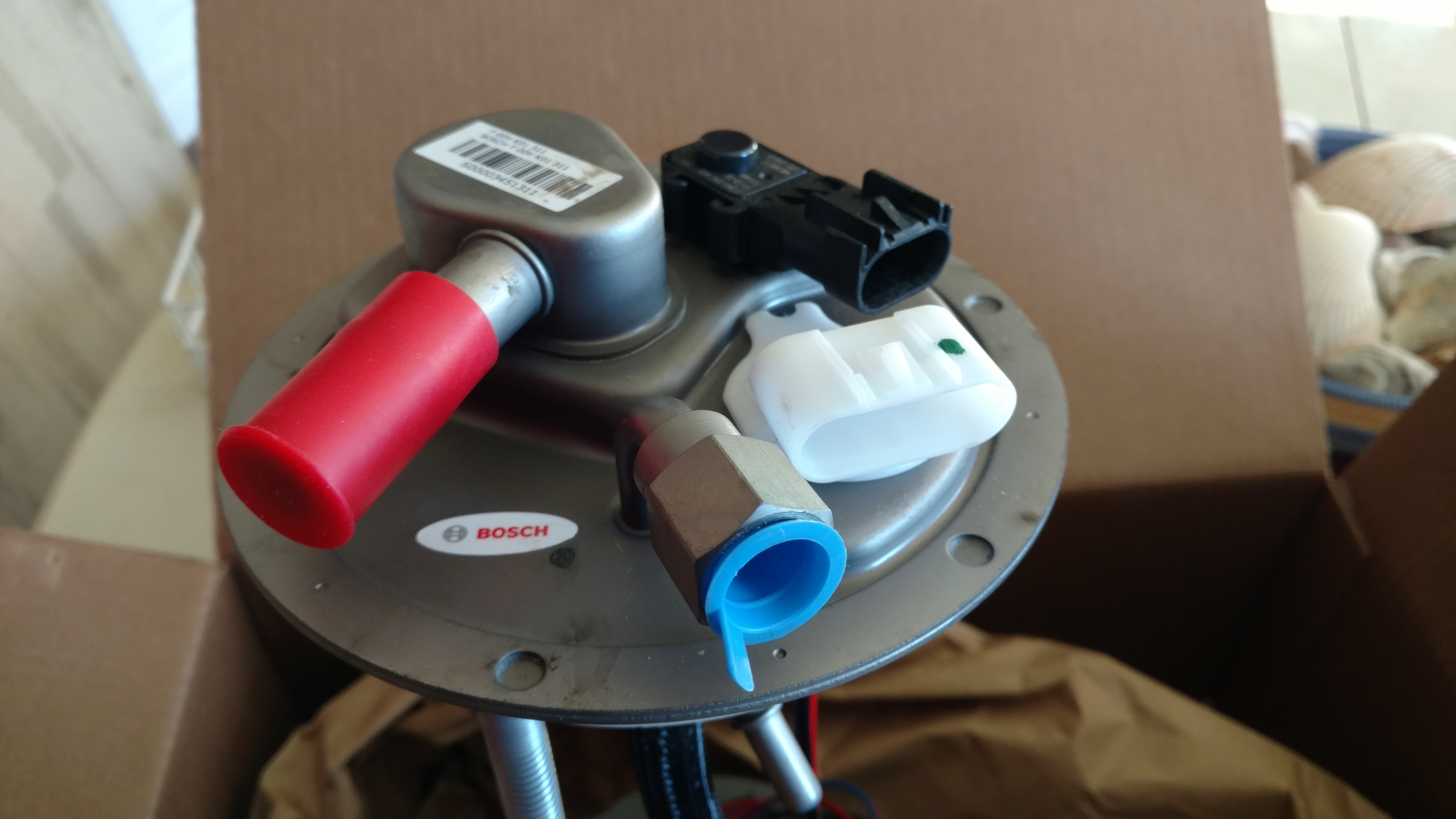

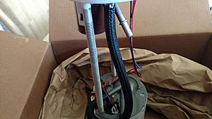

This is the Bosch 67791 with the screw in fuel fitting that did not work on my 3.7L 5 cyl H3T. Bosch lists it as compatible, so all the vendors do as well.
I selected it for the metal lid and the Bosch reputation. If the pictures provided by ACDelco were better, I might have noticed they were different.

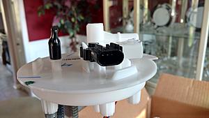

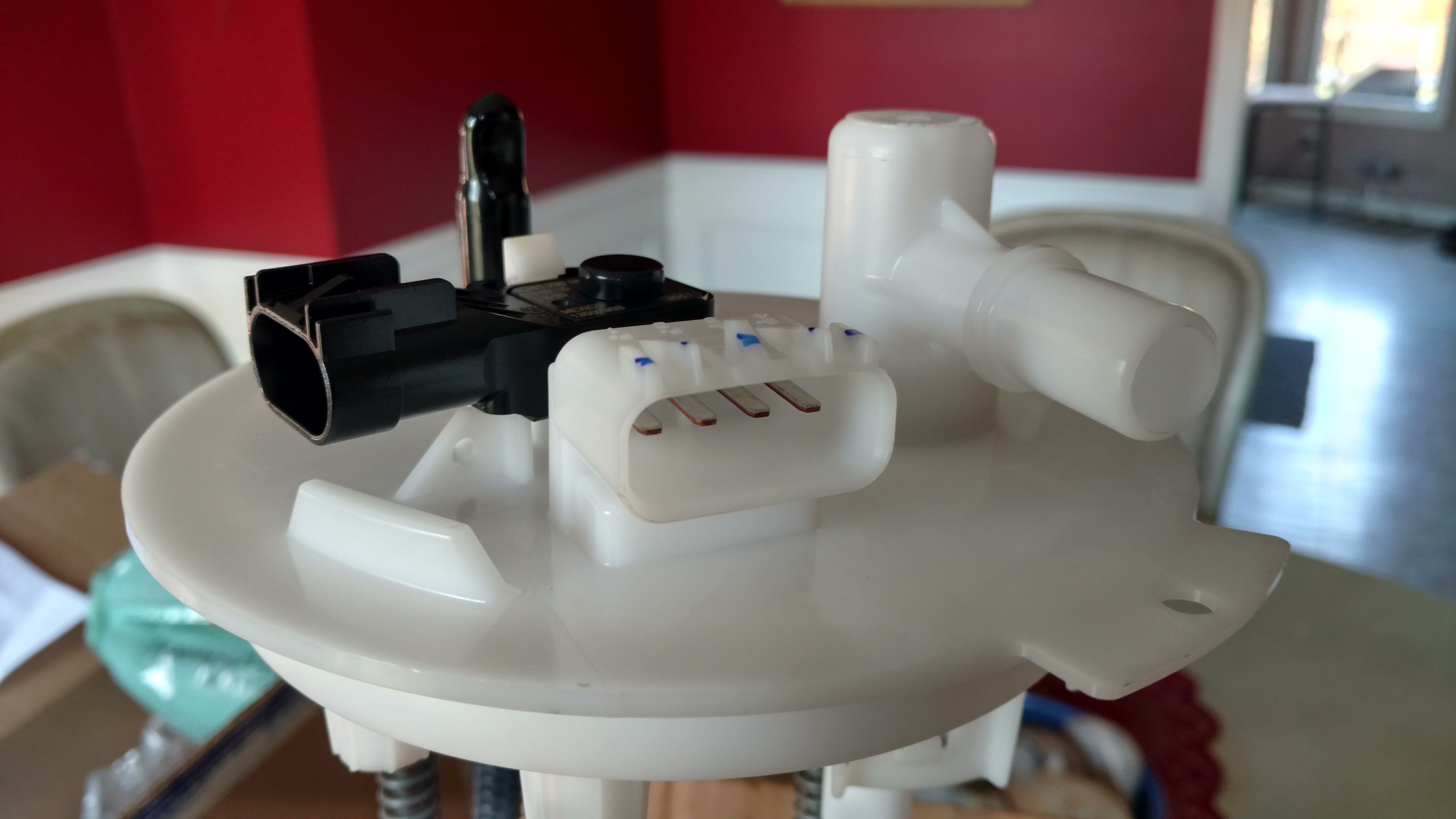

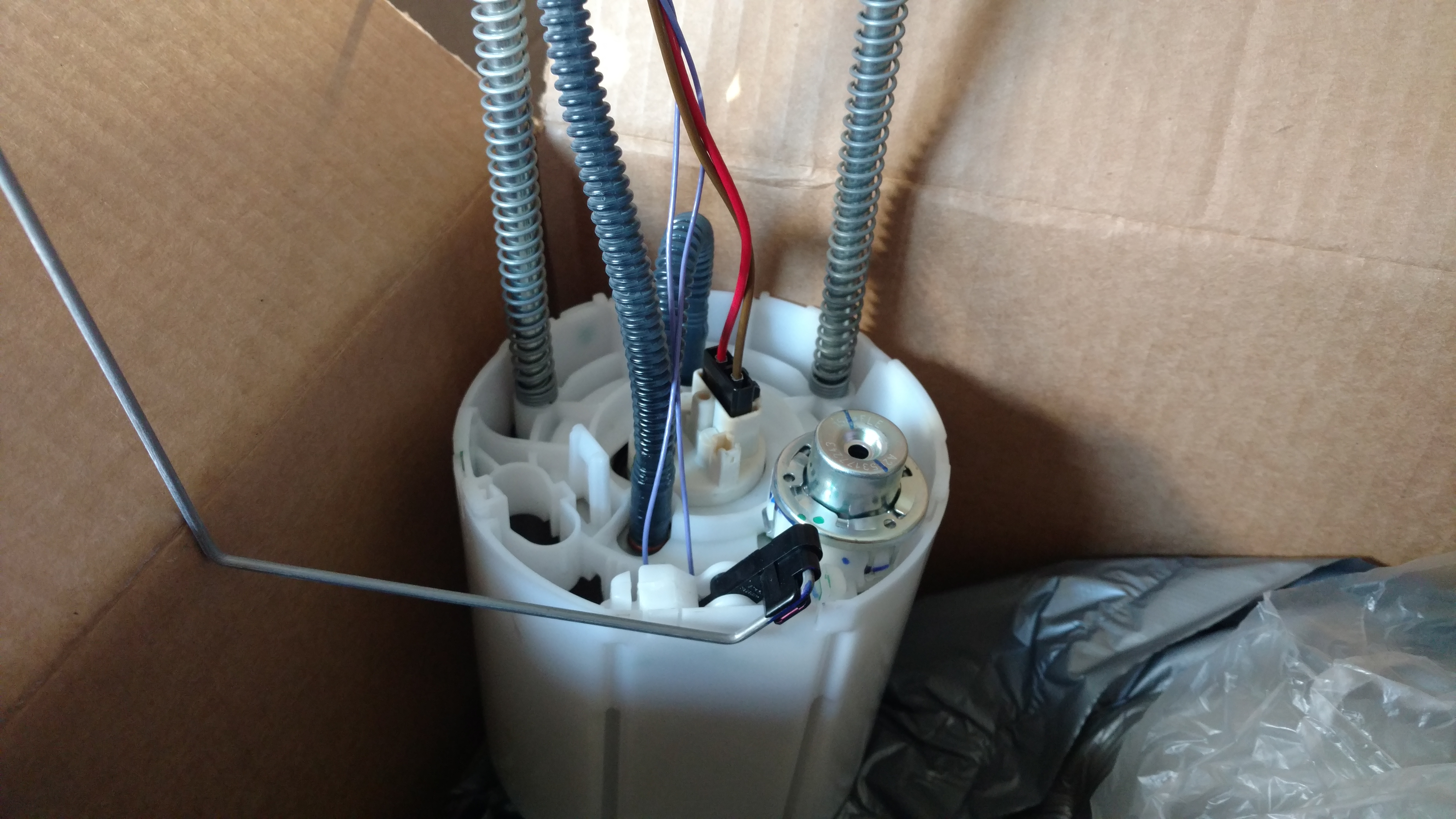

This is the ACDelco MU1879 that did fit my 2009 5 cyl H3T. There were no issues with the electrical connectors that SYCRAFT suggested. Everything plugged straight in and the truck is running noticeably better with stable fuel pressure as an added bonus.
Note: This is a protective shipping boot over the fuel line connection if that is not obvious to you in the picture.
