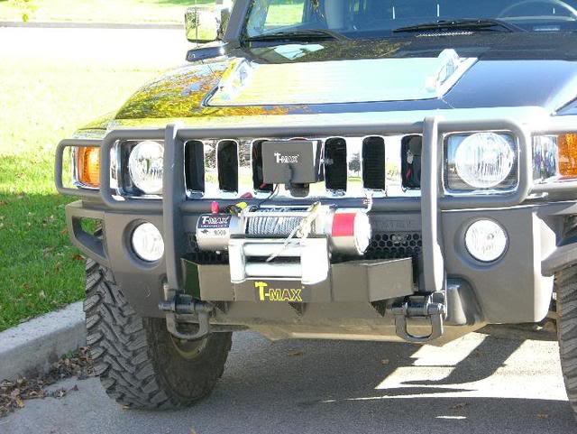

don't have the time to look for it now...but I know somone was making just a winch plate, you sandwiched the mounting plate between tow hook and bumper and it gave you a really solid mounting plate for a winch...right in the center of the bumper....looked good and was only like $200 or something.

This is what I built and installed, if you know anybody who works steel they could build this very easily Name:  winch.jpg

that looks nice BB...nice work

I could work out a price, but I think that transport would be a killer, the support is like 100lbs and I'm in Canada.[/align]
