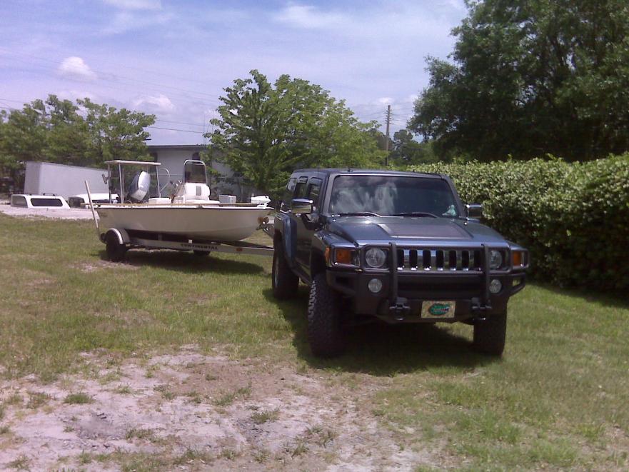

Tows my boat just fine, Backing up can be a little difficult because of the giant blind spot thats called everything behind the truck.

Originally Posted by vinny
tows my boat just fine, backing up can be a little difficult because of the giant blind spot thats called everything behind the truck.
rofl!
