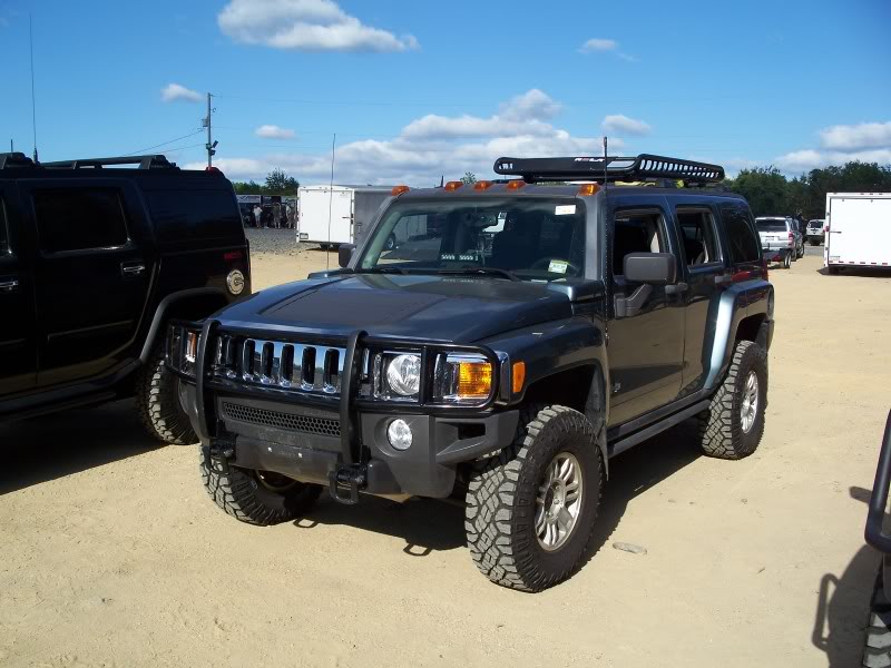

Here's a picture of my H3 cranked to 23.5" with 33" Duratracs on stock rims.

Bunger,
Your truck looks good.
I'm planning to do the exact same thing, raise torsion bars and add 285 Duratracks to my h3.
Did you add new stops and replace the front shocks when you added the tires?
Would you do anything different?
Do you recommend raising the torsion bars?
Any performance (handling / power) issues with raising the torsion bars and bigger tires?
Thanks.

Do a search, this topic has been beat to death many times, read what's out there.
So long as you do not exceed 23.75-24" from the fender lip to the center of the front hub, you do not need to do anything else except get an alignment. You can add extended bump stops if you want, as well as extended shocks if you go past 23.75". Adjust the T Bars, then decide if you want stops and shocks.
No brainer actually.
