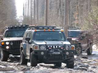

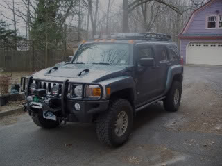

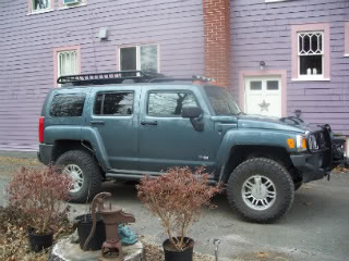

I don't have any pics in my album because I spend more time over at the Hummer Offroad forum than I do on this forum but here's a couple pics of my truck. I'm running 33" Duratrac's on the OEM 16" rim. My tires are fairly quiet.
