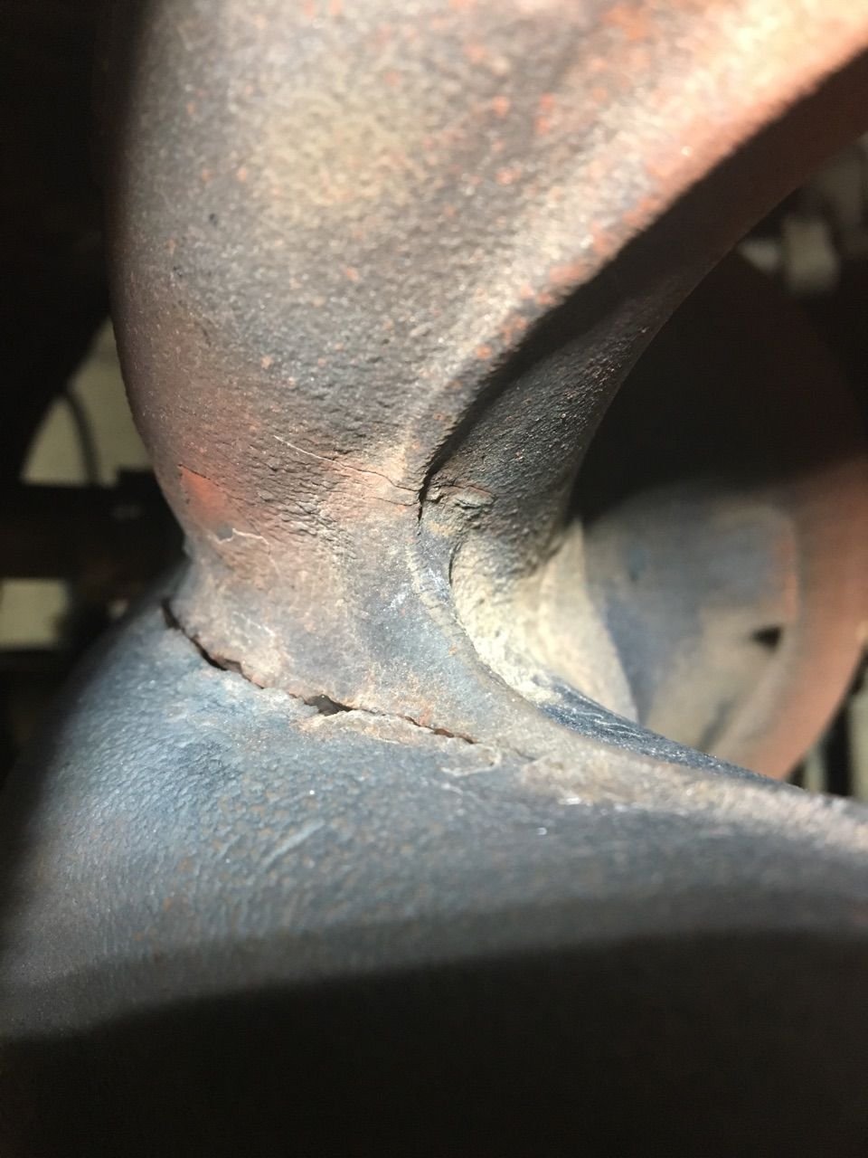

Old Mar 20, 2018 | 08:51 PM
hummer_on_fumes's Avatar
Joined: Jul 2013
Posts: 594
From: Virginia
Exhaust manifold is prone to cracking - here is what happened to mine
