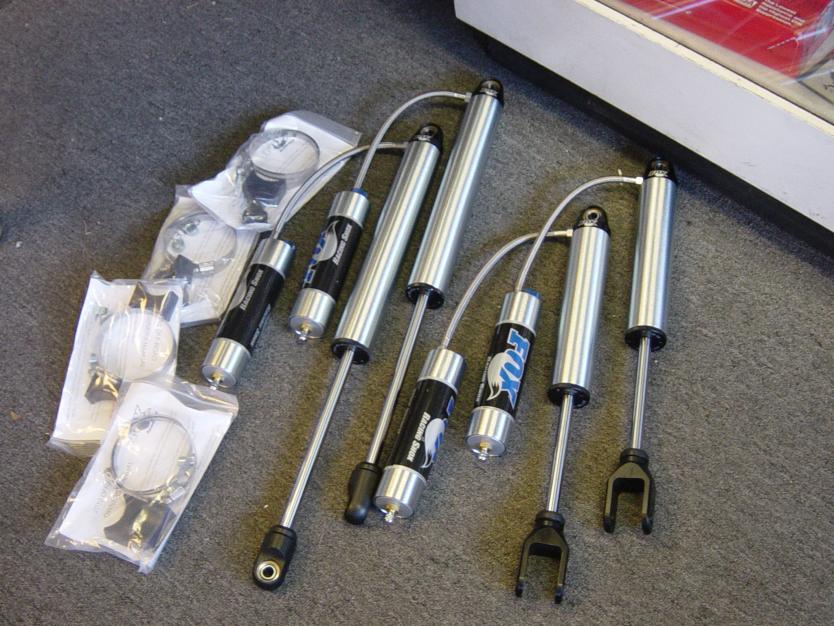

Default Did the Rancho 3.5 lift
Removed the overcranked torsion keys and went with the Rancho 3.5 lift. Solved the over extension bang in the front end and nasty bump steer, but spent a fortune on custom mounts for remote reservoir shocks to fit properly. Happy with end result...wife needs to get over how much I spent..... Told her to go out and buy some new shoes....(just kidding...I'm not that brave...)
