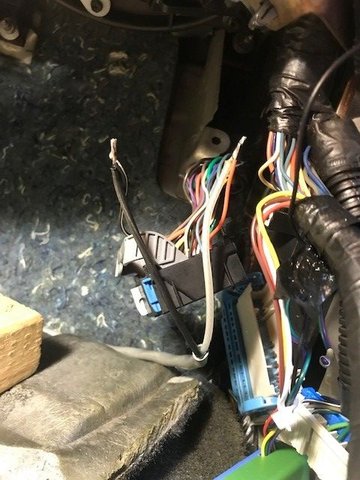

I replaced the battery terminals today. While I was at it I hooked up a voltage meter and read battery voltage while running right from the battery, then along the fuse block. My lowest reading was 14.2 VDC and the highest was 14.3 VDC. So, holding steady. My next venture is going to be tracing out the grounds to all of the computers and making sure they have good connectivity.

The battery terminals went in without issue. I then hooked up a battery charger and just left it on for a few days to get the battery topped off. When I shut it off I checked the resting battery voltage with a meter and wrote it down. I'll go back this weekend and check it againto see if the voltage dropped any from just sitting; could be time to buy a new battery.
To get to the grounds I had to pull the front seats and the center console. The main ground for the BCM was under the carpet for at the rear of the console area so I peeled the carpet up from the front back. Fun fun fun.
I have decided to re-run the power circuit to the BCM. If power fluctuations cause issue then I will eliminate that by running new hot and ground wires. The only plugs I will have to deal with will be the ones into the BCM itself. I'll snap a few pictures once I am finished.

Funny thing was, that was the easiest one to get to. It had 4-6 terminals under the screw. I gave it a bit of a loosen then tightened it. There was no corrosion. Under the carpet looked good as well. Everything looking good is what led me to just running a new hot and ground from the BCM back to the battery. I will just put in an inline fuse.
The main power to the BCM comes in on A7 (orange wire), so I'll just cut it off at the BCM and run a new one straight from the battery. The same with the ground.

I checked all the harnesses for evidence of rodents; I have been lucky and there isn't any chewing or left over nests.
I completed running new power to the BCM. I used a #14 shielded cable with 2 conductors and soldered the wires on the BCM side then covered them with heat shrink. I applied dielectric grease to all the plugs I could find. While I had everything taken apart I mounted a dual USB outlet on the back of the center console and replaced the shifter boot. I'll keep you all updated on how everything works out.
