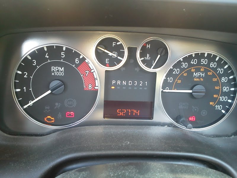

Can someone go out to there H3 and do this quick test for me?
I get in, turn key forward but don't attempt to start car, just turned forward enough that you could work your ventilation fans and such. After everything lights up for a few seconds, most of them should shut out.
Is the light with the padlock symbol on it supposed to be lit up or not (see picture attached)? After I turn the car over and release the ignition key, it goes out (obviously the car is still not starting, so you probably couldn't simulate this one).
But could someone tell me if that is a norma light? I never seen it before, but then again maybe I just wasn't looking.
Note: my doors were closed. Don't think it should matter, but just thought I would state the obvious.

Old May 12, 2012 | 04:01 PM
Posts: 13,113
Security light. This light will come on briefly when you turn the key to START.
The light will stay on until the engine starts. If the ignition is turned on, and the light flashes, the Passlock system has entered a tamper mode. If the vehicle fails to start, see Passlock stuff in your manual.
If the ignition is turned on, but the engine is not running, the light should be on solid.
