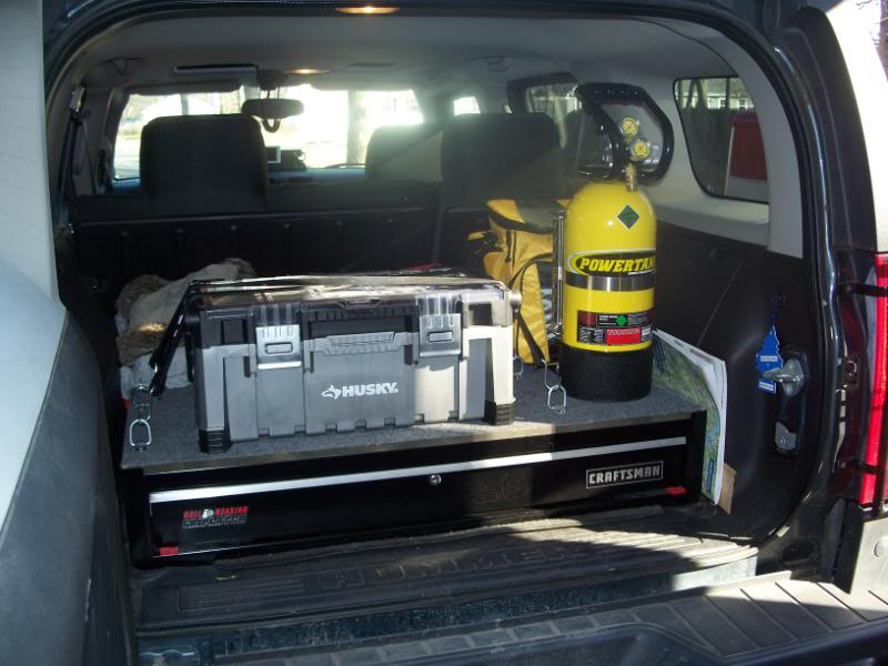

My onboard air - a PowerTank.
Can run air tools for the trail emergency or air up about 30 times on a tankful (about $12.00 to refill with Co2).
