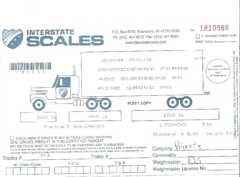

The H2 will easily tow 7000lbs.... but I would never do it daily, or even weekly....
The heaviest I've gone was.... (it still did 70 with the cruise set)
