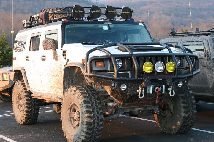

Bumper... Warn is the cheapest/easiest option for you. They look nice, and they install with MINOR hand tools. I have a lot of pictures of the install... but the best thing about the warn setup is it's attached to your frame, not your bumper.

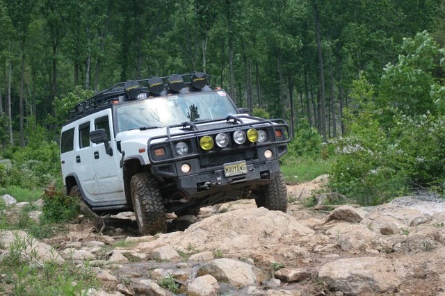

BTW.... here is my resume so to speak....

with the warn

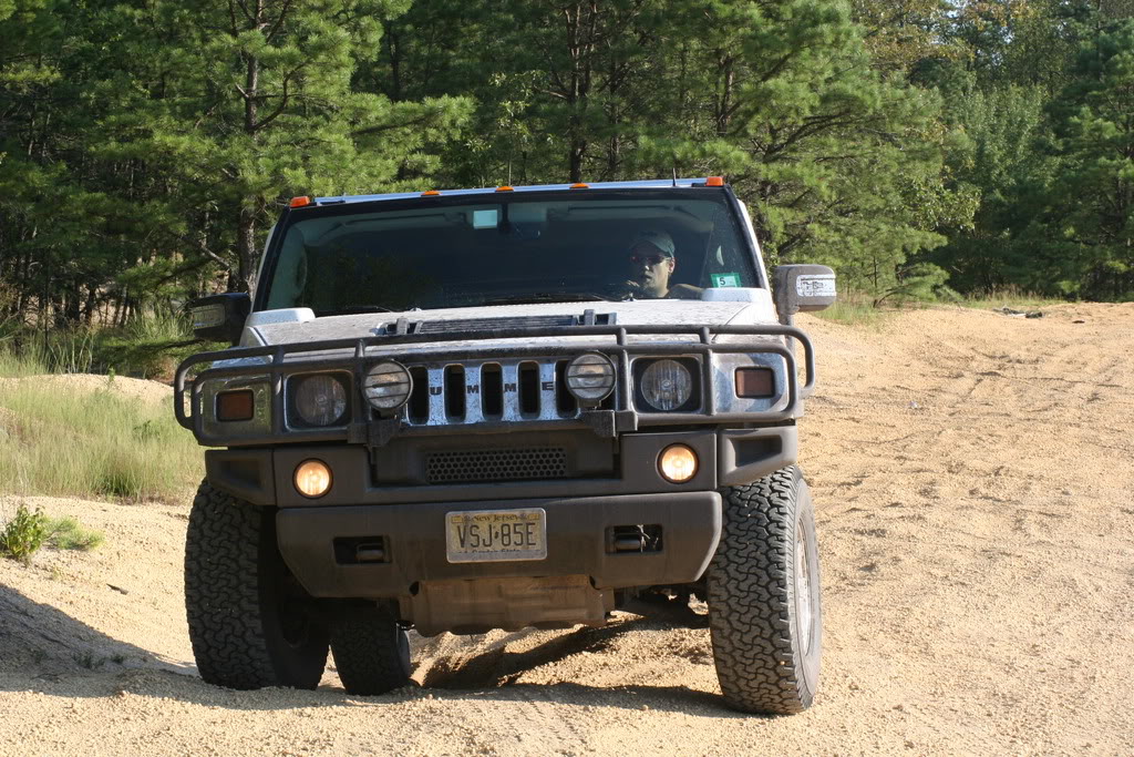

Rancho vs Fabtech
Old Oct 2, 2011 | 01:24 PM
Muddydawg75's Avatar
Joined: Mar 2007
Posts: 11,001
From: Red Lion, PA
stock just for S&Gs
