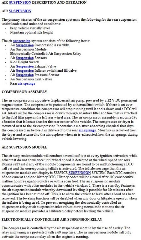

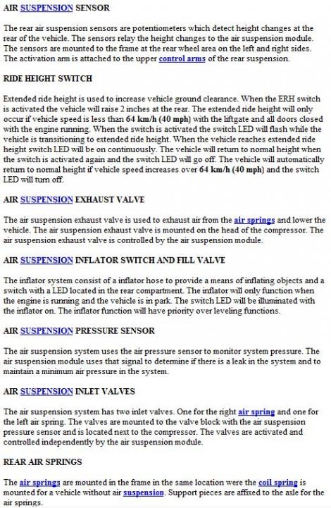

Different components of the air suspension attached.
Attached Thumbnails h2 Air Ride Failure Question-air-suspension-1.jpg   h2 Air Ride Failure Question-air-suspension-2.jpg
