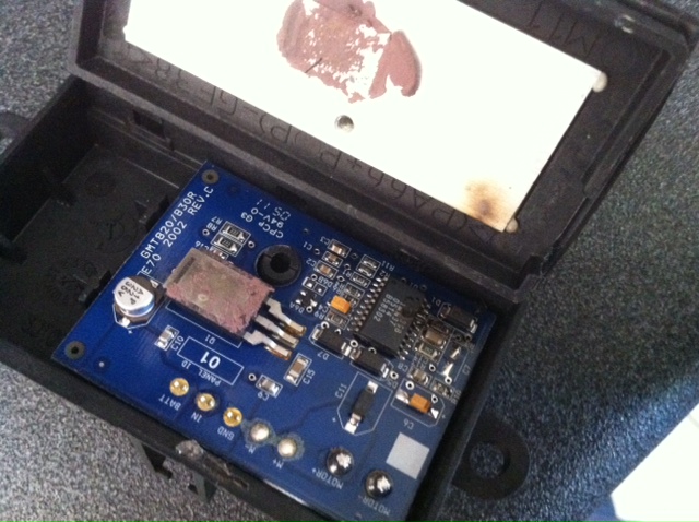

today in my H2, the blower not running
i discover that the AIR CONDITIONING Module was burned !!!
12V is OK before the module
12V is KO after the module
did you enconter this problem ?
i will buy another module but it appear strange that this module burned !!!
here it is :

you let the magic smoke out
Thats your blower motor control btw.

If it overheated, that big chip in the middle would be discolored.
Looks like some component in the upper right smoked on you.
I dont ever recall any posts on that control unit dying, but that doesn't mean anything.

What you burned up should just operate the blower fan. That post above is saying the entire hvac controls do not light up. Do your controls light up?
