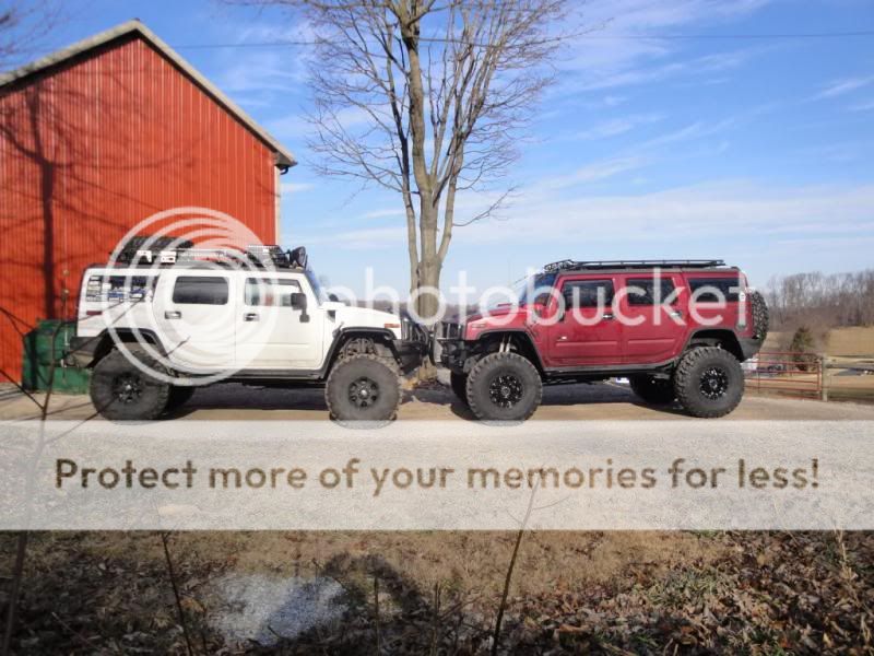

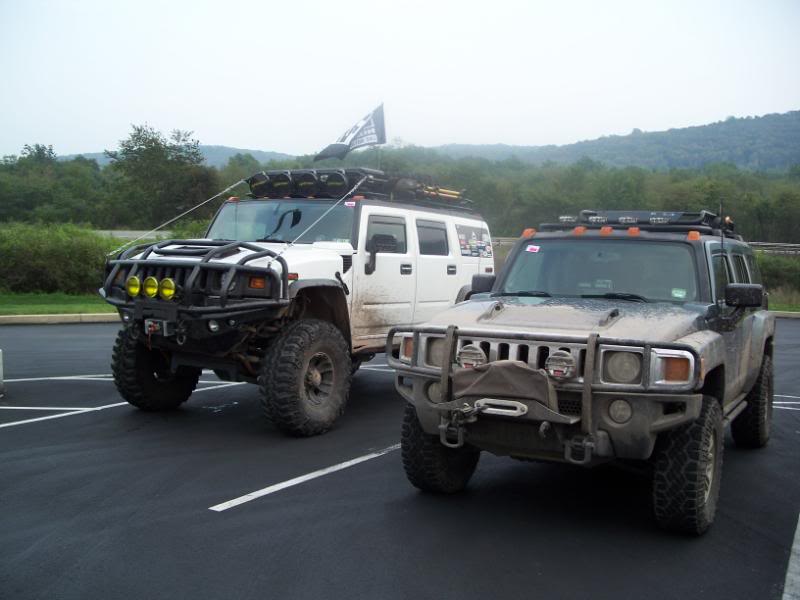

If done right. 6" lifts are for more than "just for show".
6" Ranchos with 41" tires.
Those look really good. They also fit my "smallest lift needed to fit the tire size you want" idea. I don't think a 6" lift falls into the "really high just for show" category, although I'm sure some people do add a 6" lift and don't wheel.
Nice rig!
That's cool too, but you definitely need bigger tires to fill your wheel wells.
