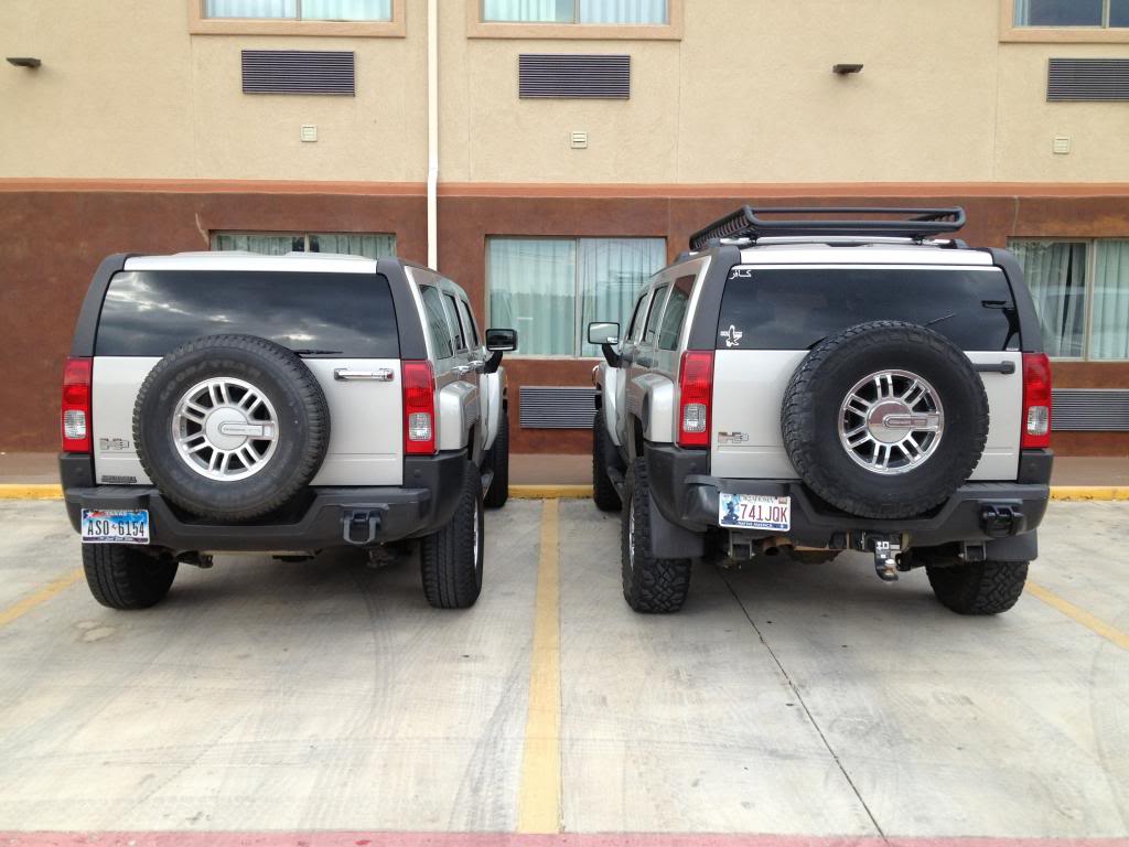

This is mine on 33's next to a stock H3 with 32" tires in San Antonio last month. All I did was a t-bar crank in the front to 23.6 and a set of shackles in the back. The shackles weren't necessary, but I had a couple of obstacles back in Texas where I used to go that I wanted the extra break-over angle for. Going to 35" tires would only put my truck about 1" higher than you see in the pictures but would also mean a bigger hit in mpg for a daily driver.
